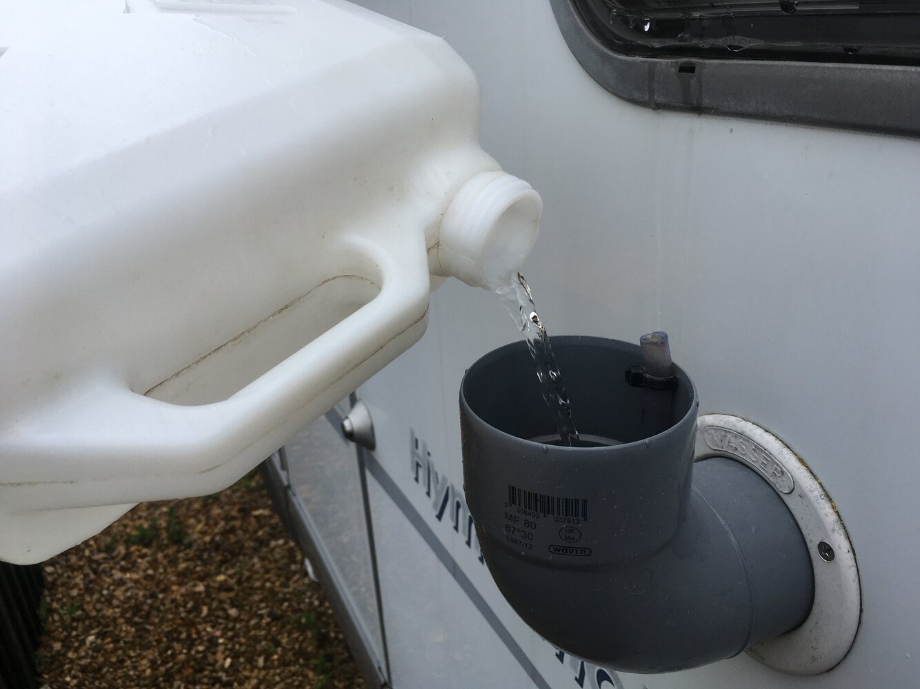

Also I have a 80mm elbow that fits in the filler for when I use a can.

The one I have uses a smaller elbow so it goes directly into the filler itself rather than into the outer edge which can be a bit mucky, we drink from our tank but if you don't this won't be such a concern.
