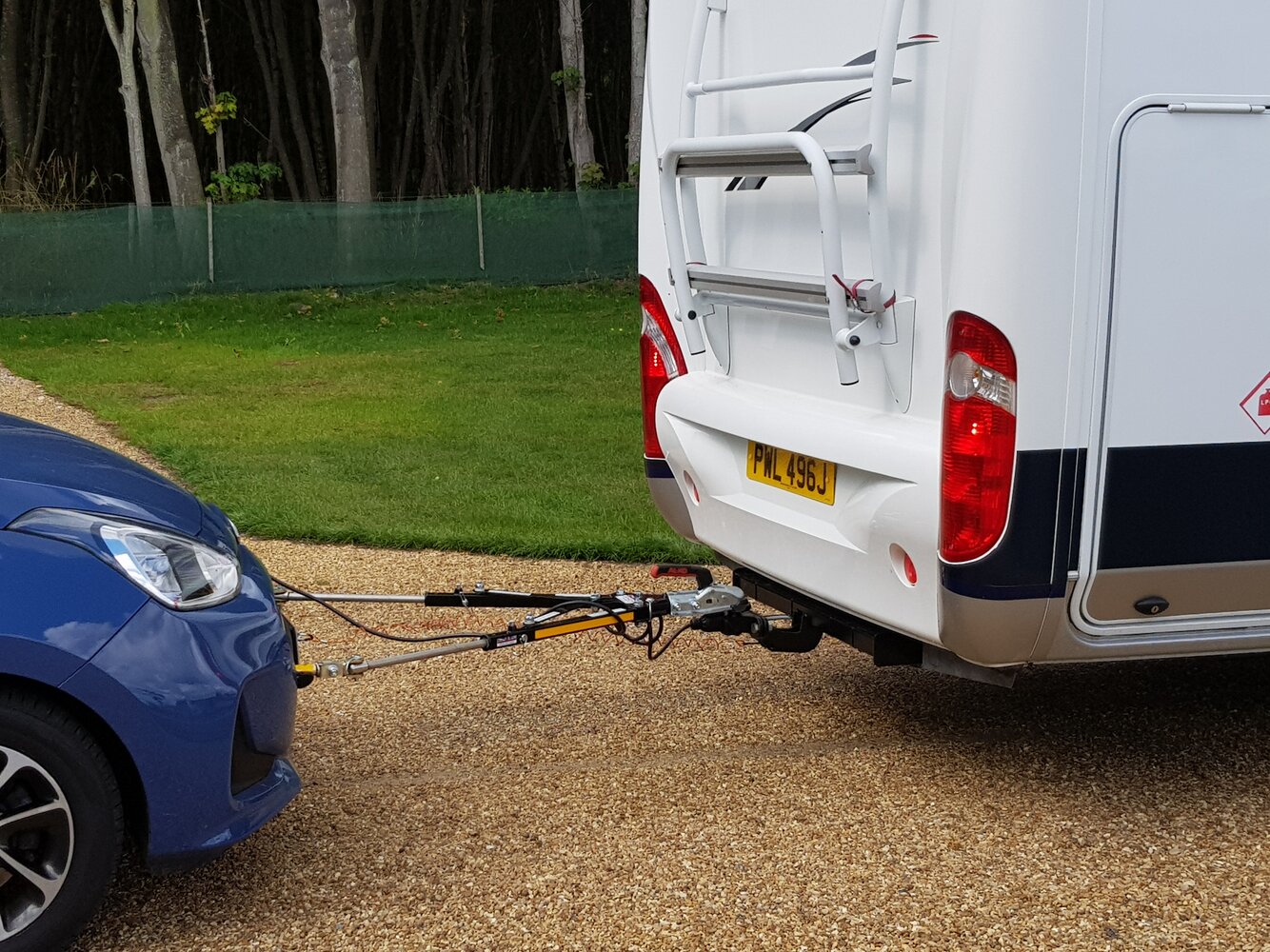

After reading many posts here and elsewhere we are considering both a “A” frame and a micro maxi trailer.
Our first step had been to book into Watling Engineers to have a tow bar fitted. We have chosen an option that allows either method of towing.
Now to the questions.
Our Autotrail Delaware had a max weight of 4500kg, 1500kg towing capacity, and for the combined motor home and towing 5500kg.
Am I correct in thinking that if the actual loaded weight of the motorhome is less than 4500kg I can use the remainder for the trailer and car up to1500kg?
Secondly, my car is a Morris Minor convertible with a kerbside weight of around 770kg. The term is confusing because it could include a 75kg for a driver, or it may not. I understand the micro maxi trailer is around 400kg - give a combined weight around 1170kg, 170kg above the potential weight I might reach.
There are other factors I do not fully understand-
The tow bar will be around 35kg but most of that weight will be 2 metres from Rear wheels. The trailer may need extra parts that can’t be stored in the motorhome - winch, coupling etc... I can store the car spare wheel and rear seat in the motorhome, and leave it low on fuel.
Do you feel this approach is feasible?

Hi we looked at both options but the A frame option won, for a few reasons. 1- you will need to store the trailer, 2 - The weight issues with a trailer and all of its bits and pieces. 3 - Storage of the trailer on sites. 4 - The pain of loading and unloading the car. We went for an A Frame from TowAframe it is light weight stows easily in the boot of the car and takes only a few minutes to put on. It has an electronic braking system which works on all four wheels, and technically is far ahead of the trailer override system and it can be reversed, which most trailer override systems will not allow unless you get out and apply the reversing lock to the tow hitch.
We have used this all season and are very happy with it.
