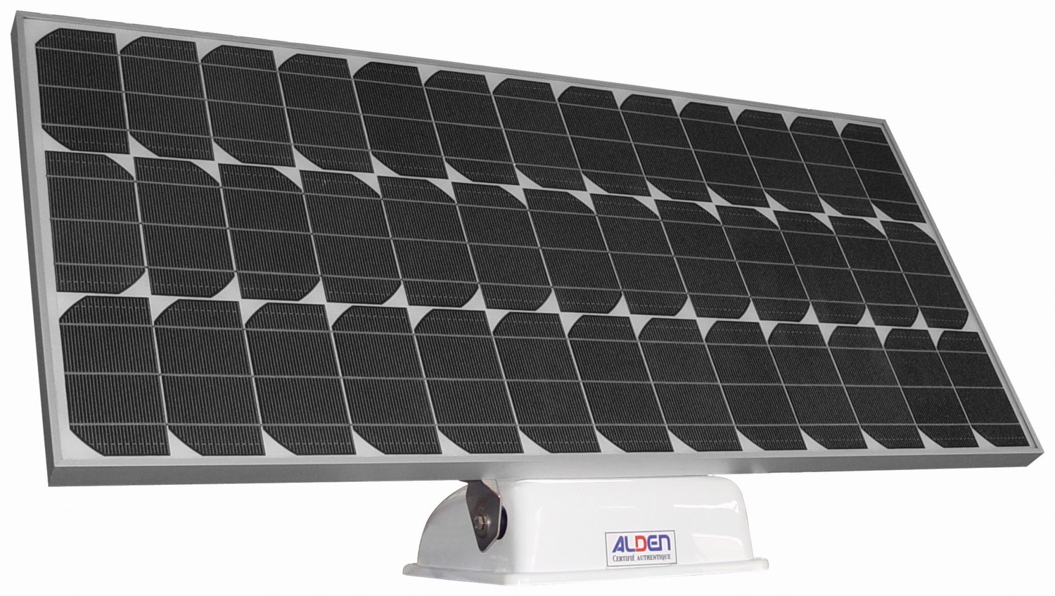

Picture above found on internet from
At only Ā£23.95
Or is that solution too easy or simplistic?
If mounted on roof near rear Heki roof light then one could reach out and raise/lower the panel without getting up on the roof from outside.

That looks great. Would it be safe and secure enough for driving? This website caters to houses, not necessarily for motorhomes.
