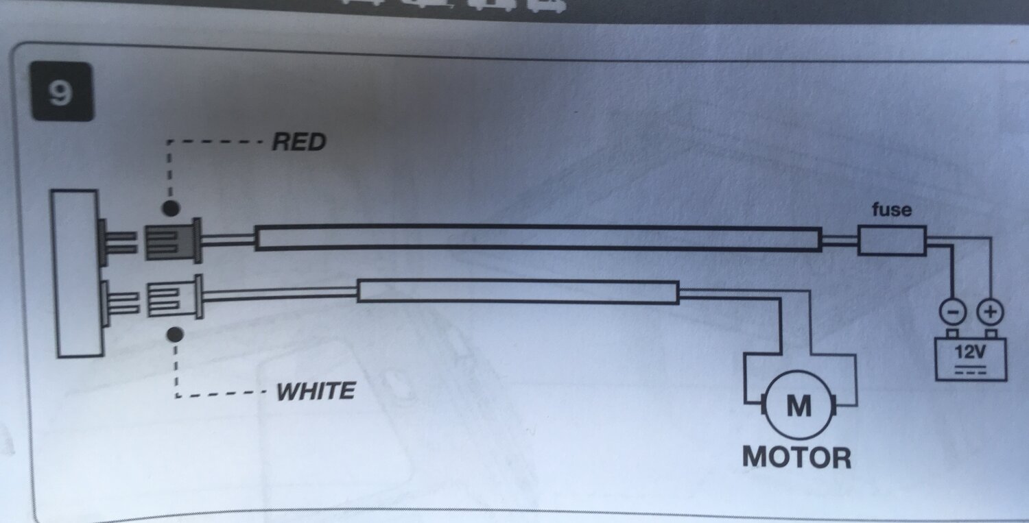

They don't, that I can see anywhere. Also the wiring diagram just says "fuse". Doesn't bother to give an amps rating. (n)
Yes it is 12V.
In that case the wire that goes to the fuse is the positive one
Rather stupidly they have both wires running to the fuse. In a black and white diagram too! :confused:
I assume that the "red" plug can only plug in one way "up". If so it is probable that the connector on the red plug furthest from the white plug should be the positive.
