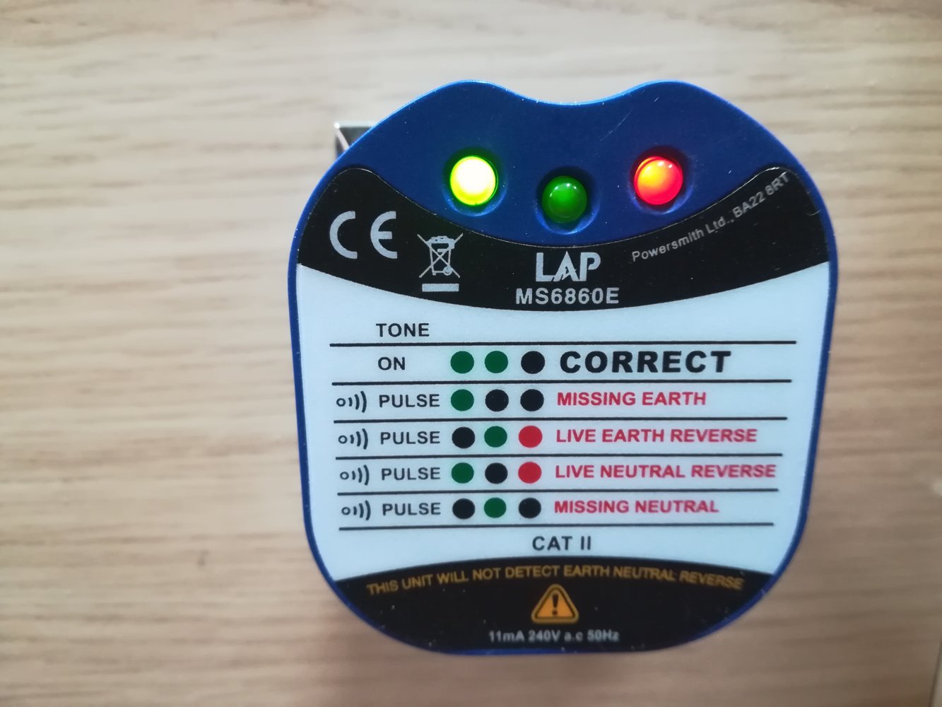

So I'm reinstalling my sunshine solar 1500w pure sine inverter in the MH, and I decided to check the plug socket that is powered from it with one of the plug tester thinggys, well anyway it's showing reverse polarity as the error, and I get the exact same error when plugging the tester directly into the inverter.
I've checked and rechecked power in to inverter from the battery, and it's correct.
Any ideas or is this normal for one of the plugs to throw up this error when using it on an inverter, which converts from DC to AC.
Any ideas or is this normal for one of the plugs to throw up this error when using it on an inverter, which converts from DC to AC. View attachment 306058
It's normal, the inverter has a floating earth so the tester can't tell the difference between L & N (actually there isn't L & N just two lives) (y)
Phew thanks, wondered wtf was going on, thanks (y) (y)
