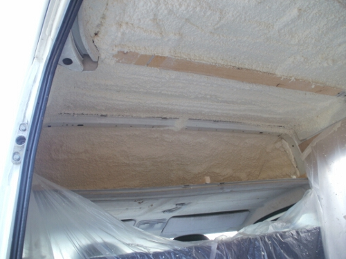

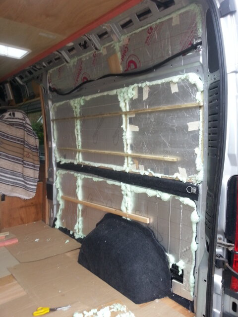

Not good that,I made sure to fill mine when doing it,50mm kingspan and recycled plastic insulation in all the nooks and crannies 😁. View attachment 695231View attachment 695229
I tried multiple different methods for insulation. Kingspan/Recticel etc were good products but inevitably with curved surfaces there were gaps. I had a condensation problem but I didn't find out until it was too late.
I then moved onto 2 part poly spray foam and it is excellent. goes on in minutes and add rigidity, sound deadening and vapour barrier all in one hit.
Here is me stripping the ceiling back and redoing the insulation up there.
Stripping the foam board insulation out and putting full strips of wood in.
Applying the spray foam.
