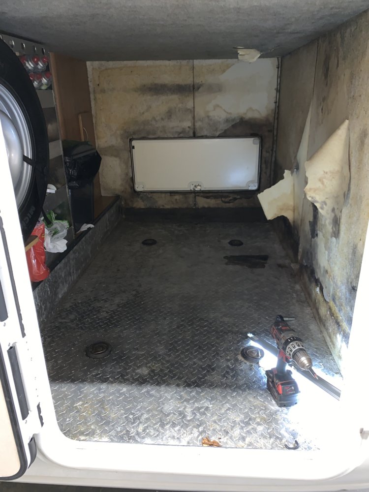

Whilst I get my list of things ordered for the hab door area repair, I thought I would make a start on tackling the 2nd issue which is the garage area.
The previous owner had covered the sides and roof of the garage. It looks crusty and I’ve wanted to get stuck into it for a while. I’ve been very daunted by it because I knew there is some damage in there when I replaced the large garage door early last year.

I started by ripping out all of the carpet knowing it would probably not be pretty undermeath. Boy, I wasn’t wrong. Lots of mouldy bits. I’m really annoyed that the previous owner covered this lot up. I’m even more annoyed at myself for not checking it out more. It’s ourfirst MH and we got carried away.

At this stage, it would be easy to be overawed by this. It looks bad. But I expected it. My initial thoughts are that it looks low down mostly. Lots around the lockers as expected. My plan is to rip it all out. It’s just batten and polystyrene after all.
I’m not planning on putting wallboard back in there. Instead, i’m going to use aluminium composite panels to clad the insulation. I’d also like to do a rubber floor with a skirting board of the same rubber flooring to help keep any spilages localised.
I’d really appreciate any encouraging comments from anyone that has been in a similar position right now!
It really doesn’t look great but, I am sure once all the rotten stuff is gone and I replace it with good stuff, it’ll start looking good again!
