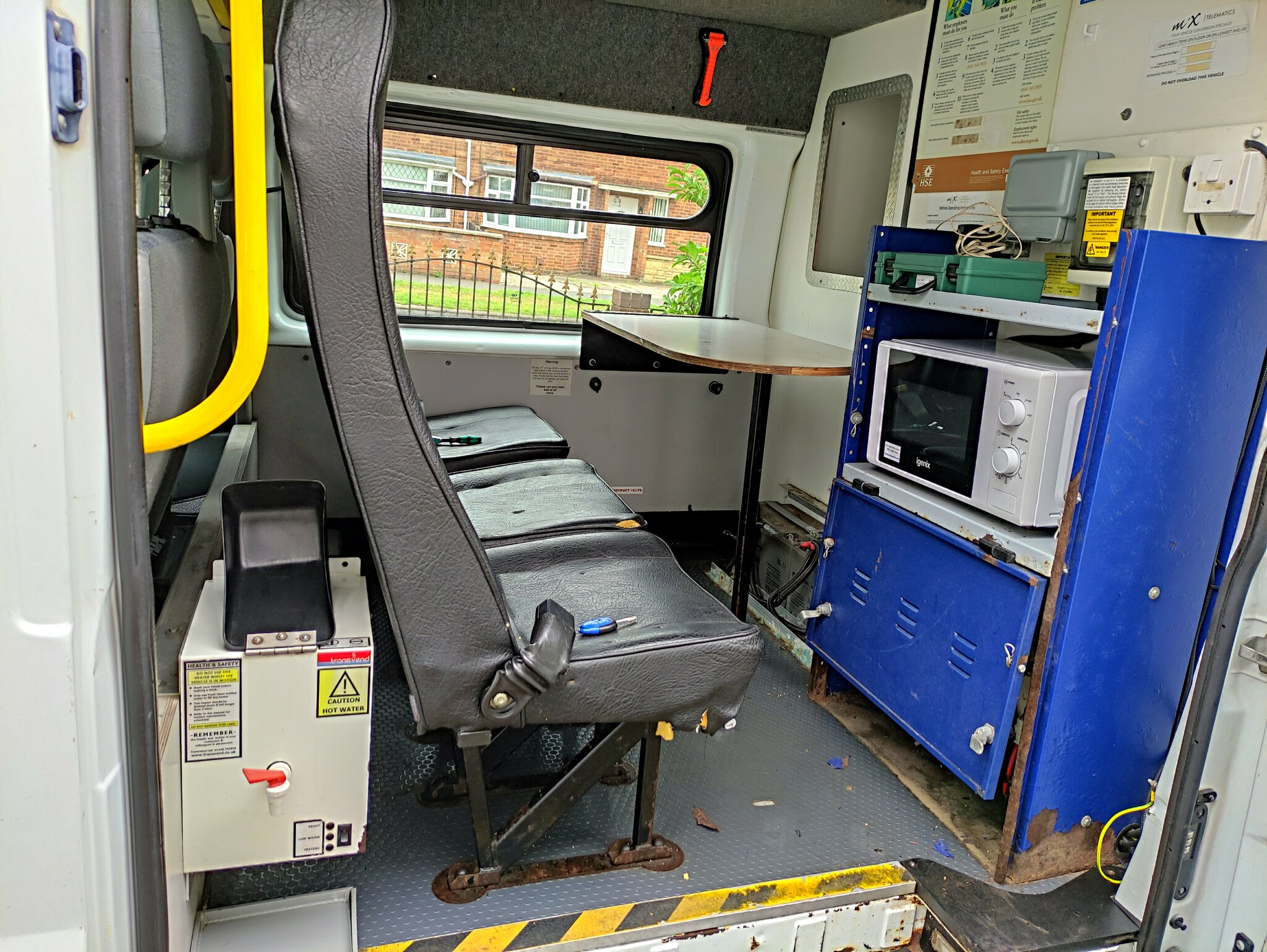

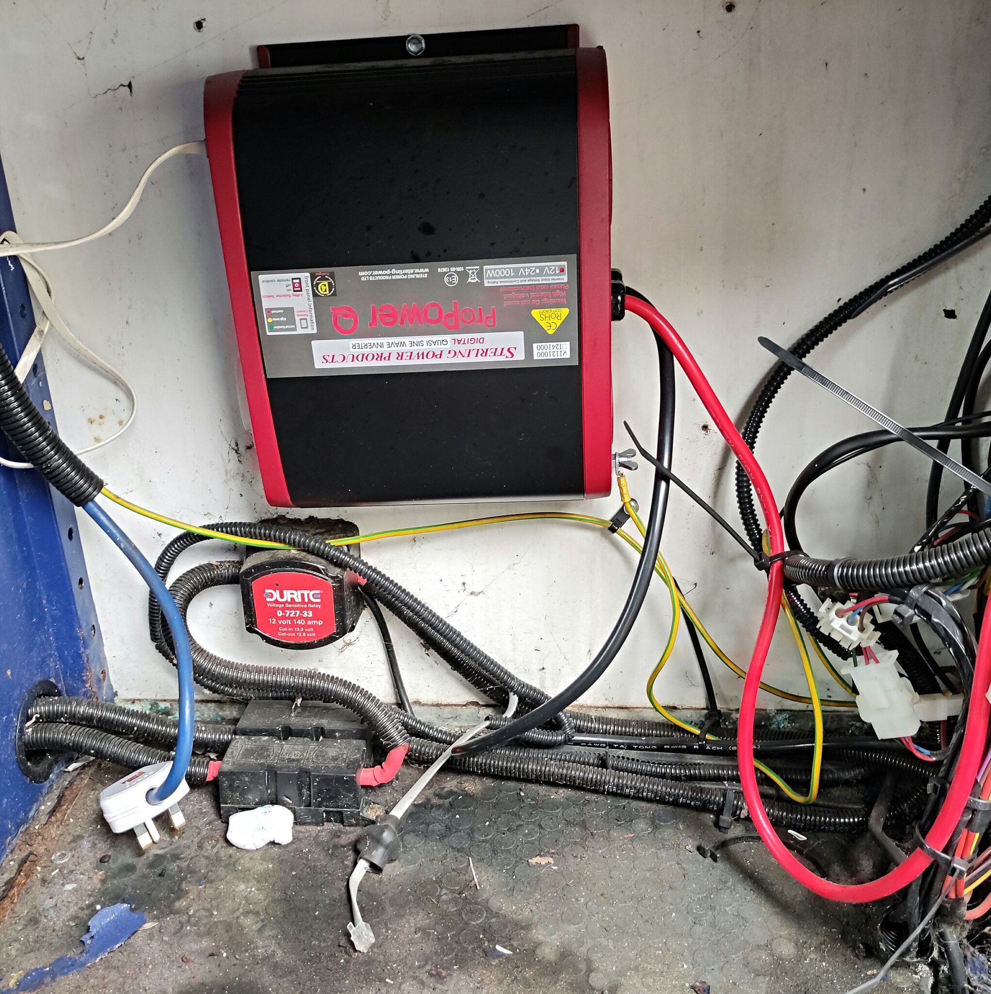

Definitely got some potential this I reckon :giggle: I will be needed some advice & recommendations for layout etc & other things

Nice a fair bit of kit you can use!
Any idea of layout?
Cheers James
I'm definitely going to ask advice on Layout - initially my idea was compact kitchen pod RHS front, one of those toilet washroom trays that utilise the wheel arch space on LHS at the rear with a Tambour sliding door which makes the width of the toilet room less than a metre and I believe just enough room to make a longitudinal bed set up on RHS rear. I will do a new separate post asked for advice on this
That sounds good saves putting the cassette toilet through the side of the van.
You could probably put a second row of seats In front of the toilet door.
Keeping it simple has alot to recommend.
Get some lining wall paper and draw it 1/4 size.
Or if you have a drive draw it out full scale using chalk.
Cheers James
