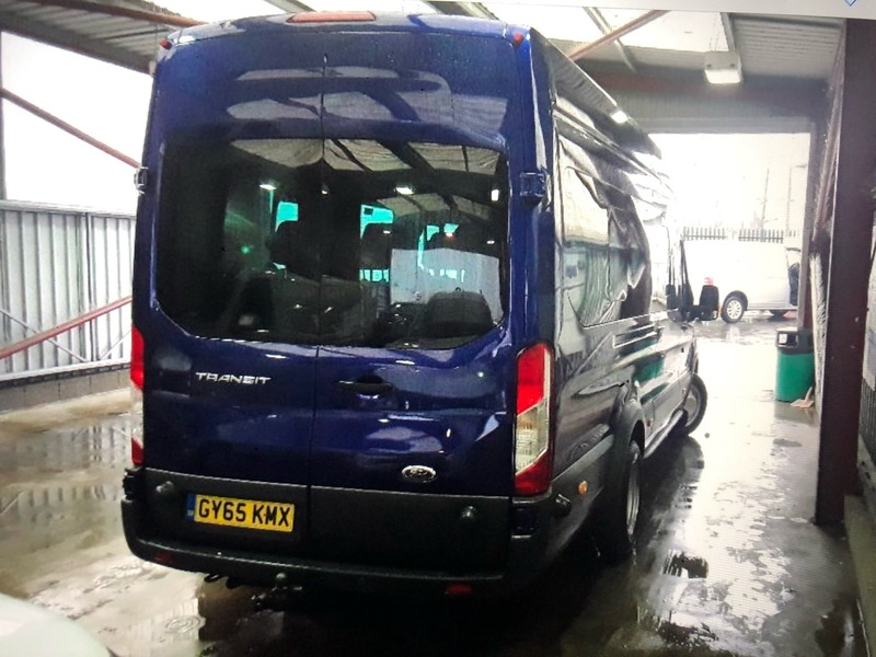

Still working on images, but was able to pull down the original sales images and some I took for an email. with an insulated floor I've certainly got well over six foot three of height inside. Andy

I guess you brought a jumbo for the space which makes sense for travelling. But then you want the height for cabinets etc.
I'm using it for a day van / w/e van and the extra height isn't a necessity and the jumbo length would be a pain in the neck.

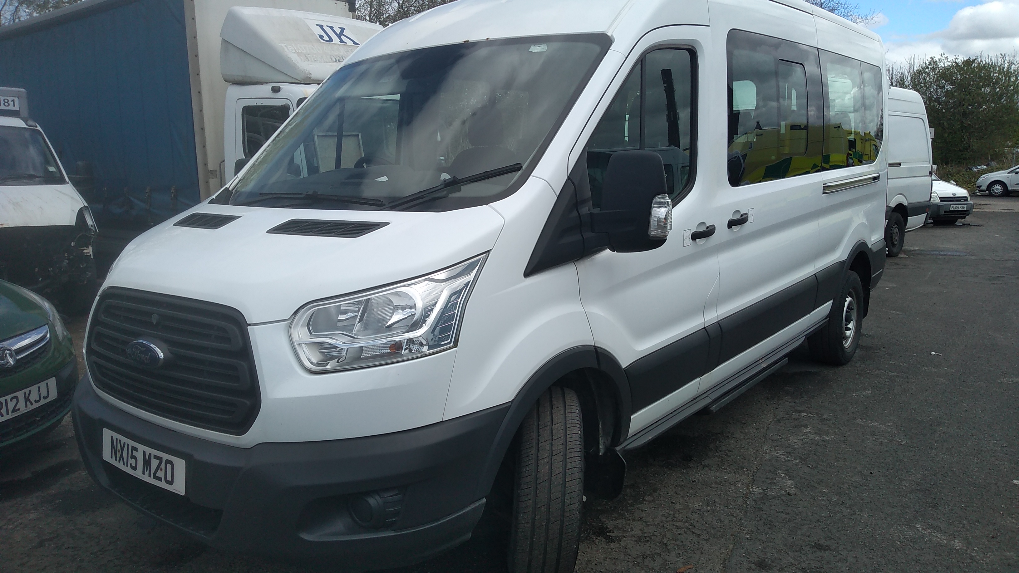

Not the best. I'm afraid.
Cheers James
