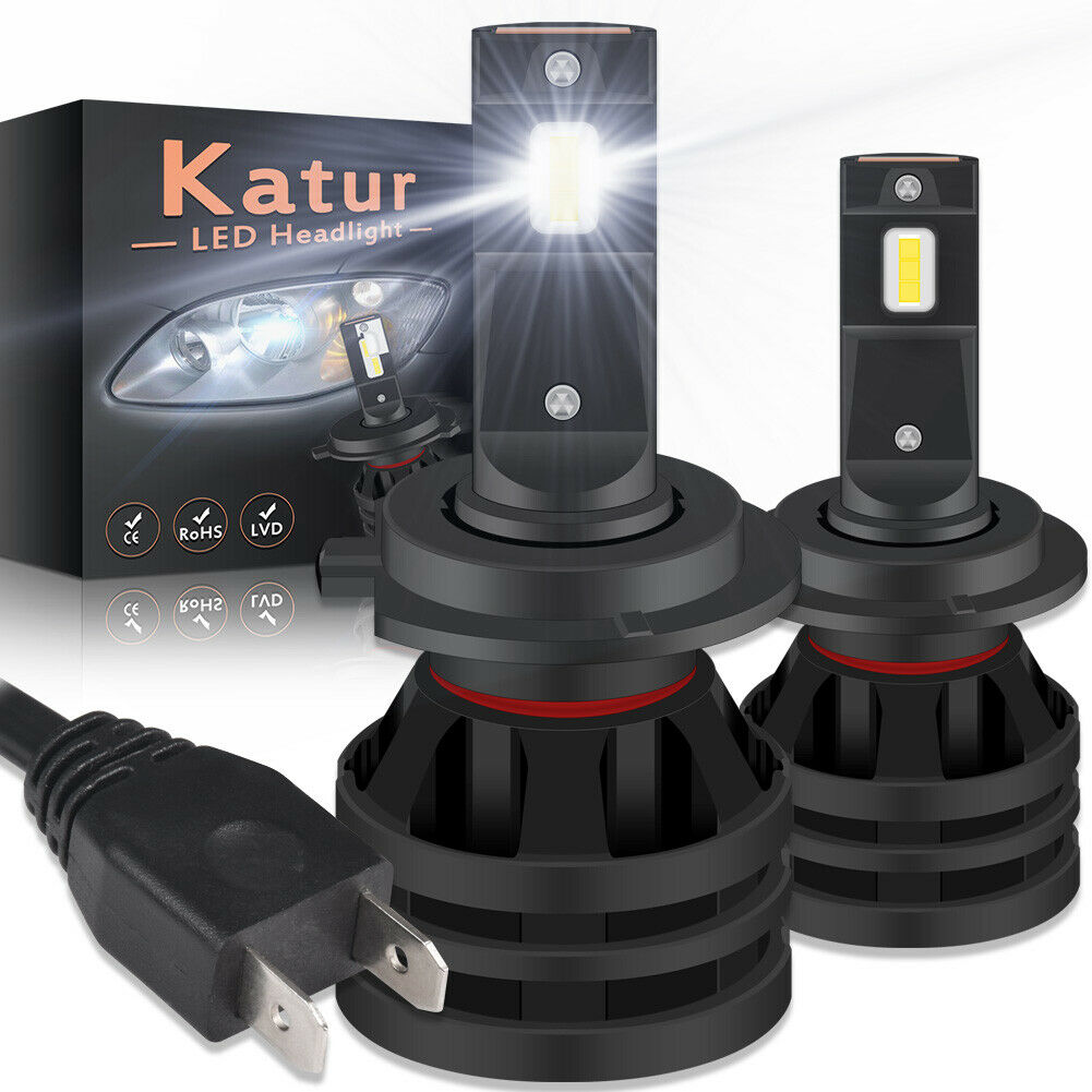

Those are the ones that all of us that have fitted them on this thread have used.I seldom have cause to drive at night but was forced into it one very dark night last year in Germany.
My 2019 Ducato headlights are so poor they are dangerous. I was having to slow down to less than 30mph at times.
I bought a set of these but haven't tried them in proper dark yet. I had them on early one morning last month and they were certainly brighter but are focused to close to the front of the van. Are the headlights re-aligned after conversion? Or do you have to wait for the MOT tester to reset them?
They are easy to fit or change at MOT time. Only two screws on my 2019 van.
You will probably need these, as the standard clips won't hold them in place.
2x H7 LED Headlight Bulb Adapter Holder Audi BMW Mercedes Skoda VW Vauxhall B15 | eBay
Led Headlight Kits. Indicator Bulbs. This will allow you to replace MOST after-market LED bulb firmly, quickly on the original headlamp housing without destroying the original socket. Indicator Leds.
www.ebay.co.uk
Make sure you fit them with the LED vertical so it matches the orientation of the tungsten filament.
I found I had to lower the beam alignment quite a bit.
