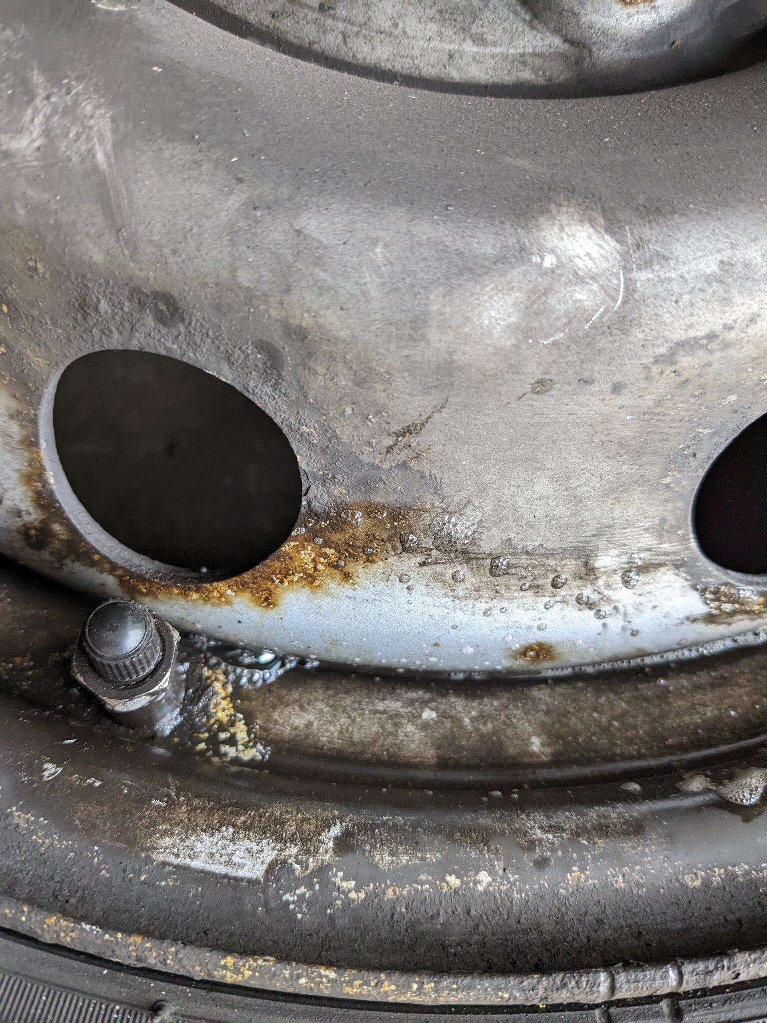

I thought that I had a slow puncture so took the wheel off, tyre ok but plenty of soap bubbles by the valve. On checking closer it seems that it's the weld between the rim and centre. I'd value any advice regarding a repair ie. welding, sealant etc.

I thought that I had a slow puncture so took the wheel off, tyre ok but plenty of soap bubbles by the valve. On checking closer it seems that it's the weld between the rim and centre. I'd value any advice regarding a repair ie. welding, sealant etc. View attachment 690753View attachment 690755
The rim and the centre are two separate parts welded together. So if there’s a leak between them as your picture suggests then it could be either weld failure or the wheel has a crack developing. The latter is favourite as it’s by the valve which is a weak point.

May I add to the voices saying scrap the wheel, if it fails it will be far worse than a flat tyre. Also bit worried you may be on the same bit of road as me when, not if, it 🎅
