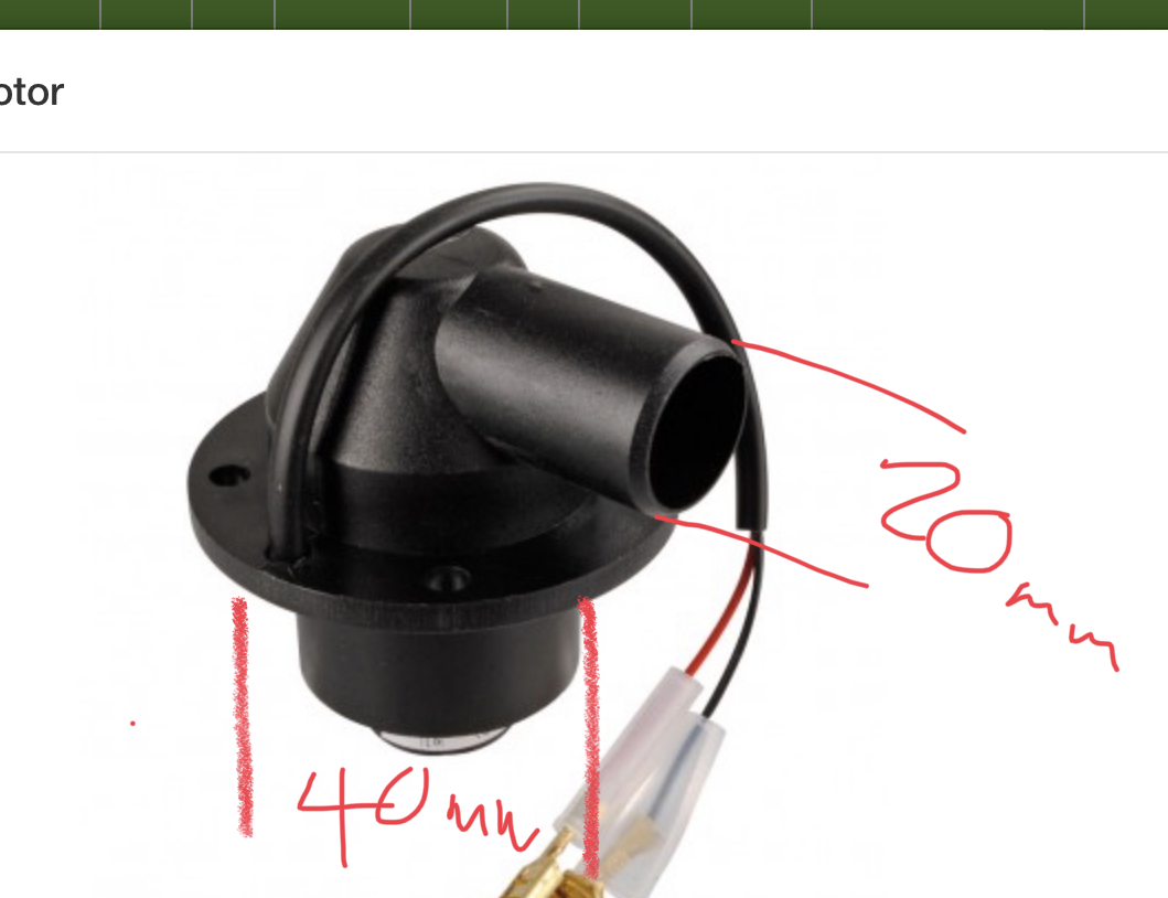

What size is the fan Nick, as I have a few knocking around.
Rough size.

I investigated my non working through the floor Thetford effort today. It is indeed defunct but I was surprised at the fan. It is only a titchy 40mm one so surprised it produces enough airflow to make a difference. Anyway I've ordered a replacement, Chinese of course but so was the original.

You will be disappointed if the replacement fan you ordered is not a direct like for like replacement as the original fans run at about 12,000rpm and the same size computer type fan only runs at about 2,000 rpm.
The one I ordered claims over 6 cubic feet per minute. I assume the high speed is why so many complain that they are noisy. As I have somehow survived for many years without a SOG or equivalent I won't be that bothered if I don't get it working.
Farnell sell one the same as the SOG one quite a bit cheaper but still about 60 quid.
