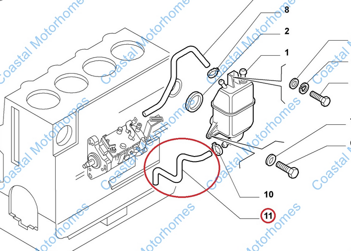

I found this ..
Looks like a crankcase breather if so it will either go to a condenser/separator or air intake.

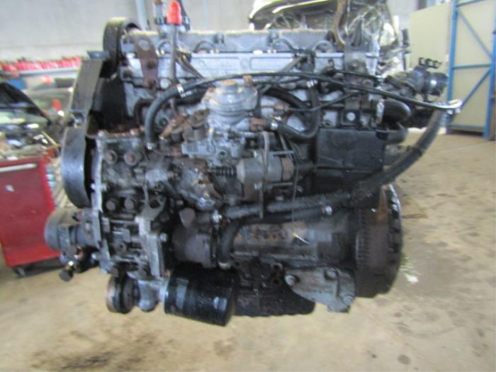

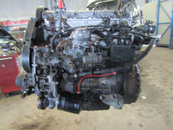

Hollyberry here I am (photo)
Just smiffy I think that's the right hose yes - but can't see what it would attach to (photo)
Just smiffy think the engine layout is slightly different maybe - although j could be being stupid
So pretty sure that is the right hose. The black box the hose plugs into (in Just smiffy 's photo) is however obscured behind the component marked in blue - I can't get behind there.
What I think is the place it needs to attach to is marked in red...
Yep danielf here a couple of shots

Another for crankcase breather.
It could well be affecting the EGR unit which will possibly put the engine in limp mode..... Poor acceleration and reduced power.
That is definitely a breather. It looks like to the black box on right of engine is where it should be. It looks too small to be a turbo pipe. Can’t see much more sorry !

Feel like I'm getting warmer... Thanks all useful diagram Lenny HB just can't see / feel that thing to connect it to!
