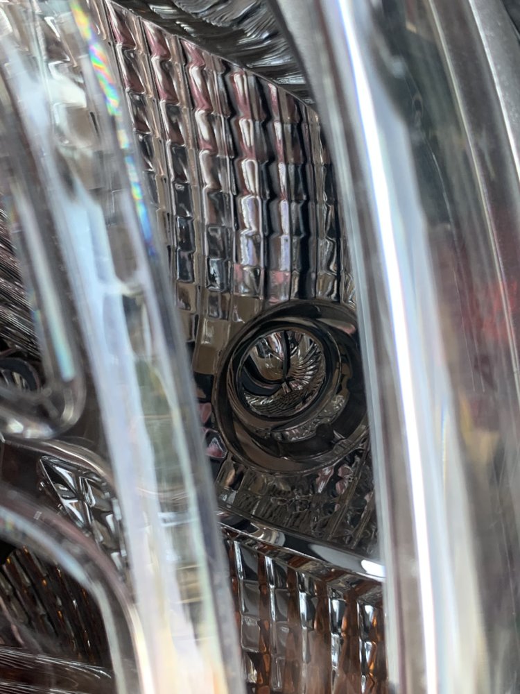

On the X290 Sevel vans, the headlamps are of the modern complex reflector design, where the beam pattern and intensity is controlled by the multiple parabolic reflector surfaces at the back of the lamp. When you adjust the position of the beam, it is the reflector that moves, not the whole lamp unit as with more traditional designs.
This does mean that care must be taken in the choice of replacement bulbs, as any deviation from the dimensions of the original bulb, particularly the distance of the filament from the back of the lamp, can have an adverse effect on the beam direction, targeted intensity, cut-off definition and scatter.
How many forum members does take to change a bulb..?
Did mine alone in 10mins including opening package of bulbs, taking out light units, fitting bulbs, replacing wire connector, testing them, putting them back in and closing the bonnet. I did use a drill to take the screws out so was zap zap zap zap just ensure you set your torque setting on the drill ?
This is what you see in the 2019 light unit with DRL’s, the silver one is the pull out pop in H7’s same on all 4, the white connector is the slight twist pull out indicator bulb, ensure you put the new one in the right way round, just turn on the indicator to test, if it’s the wrong way round it doesn’t come on and the other one flashes quickly. There is some kind of fake bulb slot with no wires going to it, maybe blanked off after DRL’s fitted, you will see it on the pic of the lens below.
