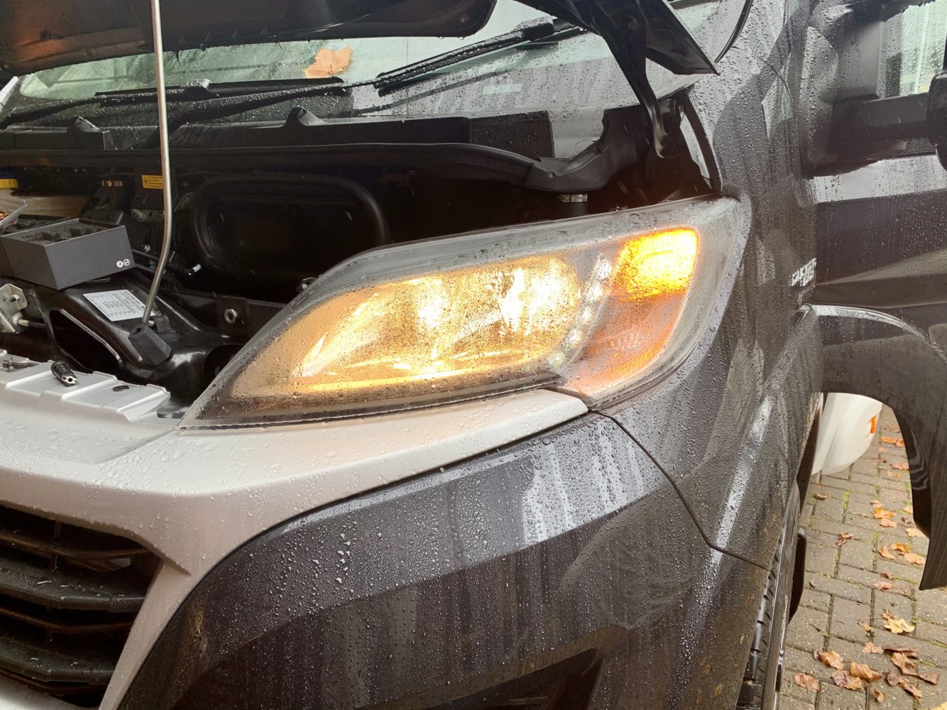

When I collected my motorhome I realised that the new daylight running lights made the headlamps look dim and yellow, it just spoiled the aesthetics of it all, I also saw that the front indicators were dim and not filling the reflector with light, SO I took action and this is the result, if you want to know how you can do it let me know, its a 10 min job and if you know what you are doing and the parts are cheap as well (y) If you want the bulbs they are free next working day delivery if ordered before 2pm, total cost for the 6 bulbs with 3yr guarantee is £115.18 including 10% off as I am a regular customer, but if anyone was interested maybe they would give me a code so others can benefit as well, every little helps :)
You will see a selection of photos including before and after here including old indicator and new, new is O/S and old is N/S but I think its obvious!

Tools required = 1 x T30 Torx bit driver + 10 minutes, don’t forget to check you have put the indicator bulbs in the right way before refitting, check indicators first which also reminds you to plug cable back in ?
This is how you get the headlights out of a Ducato, skip to them coming out as this guy goes on more than me ?.

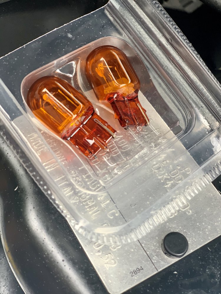

For a 2018 you need 4 x H7 (headlamp 2 x bulbs each side) and 2 x 582 (coloured indicator)
Headlamps (2 sets) https://www.autobulbsdirect.co.uk/twenty20-compact-led-headlight-bulbs-H7-pair.html
Indicator 2 x single https://www.autobulbsdirect.co.uk/582-twenty20-HF0-LED-indicator-bulbs.html
You will see below the 2 x screws you take out each side then slide the light unit carefully towards the centre and it comes out, remove the single wiring harness by sliding back clip around it and pulling out plug, watch you don’t damage the lens, have a jacket or towel to rest it in while you change the bulbs, remove dust caps, take of connector, if lucky bulb comes out with it, if not pull out bulb carefully with some pliers, it just pops out and pops back in on a built in spring, not like the old ones you had to pinch. Below are the old indicator bulbs together, a pic of the screw you take out, the long one is the one by the wing, then a pic of the old and new headlamp bulb.
Good luck, it really does makes driving at night safer and would update older vans, mine has LED rear lights already but if you don’t you can look on the site for the ones you need, any problems call and ask for Kim, she is very helpful ?
