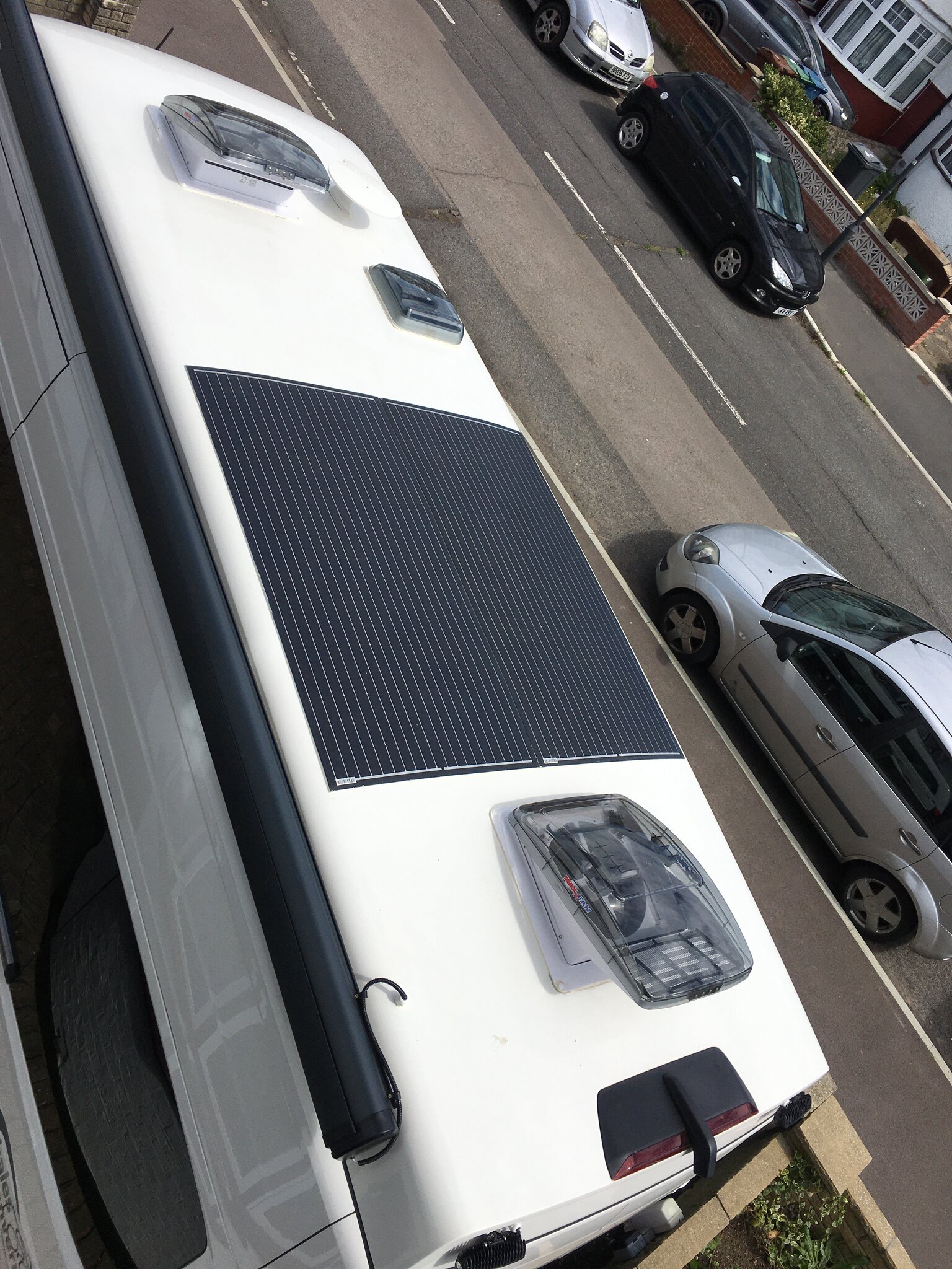

2x panels fitted 2019 on my nice and smooth fibreglass super high roof and still going strong.
