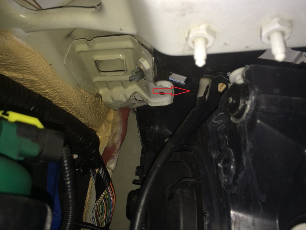

As promised, here we go, this is the scuttle drain on the passenger side when viewed from the top:
Now this is the view from behind the headlamp looking up, notice the pipe (arrowed):

I have cleared the LH ((passenger side)) very small drainage hole, ((used a thin welding rod)) but can't find a hole on the drivers side ?? Should there be one ???

My Peugeot had a pipe on the drivers side only so would not drain on the passengers side but did not cause any problems.

Yes, but it is extremely difficult to see, the windscreen wiper partially obscures is, look close to the wiper pivot and you should see it. Failing that, remove the panel above the light, 2 screws, and then carefully 'wiggle' it upwards to free the pop studs. The panel is plastic and can snap.

Just looked at mine and Ihave a pipe thats about 1 inch across that the scuttle drains into? Mine is a 2013 apache comes out under the drivers side wheel arch.

Here are some photos the thick pipe to the left side of brake mastercylinder and the large hole that feeds it on the scuttle.

So is this different from yours is this the upgrade?
