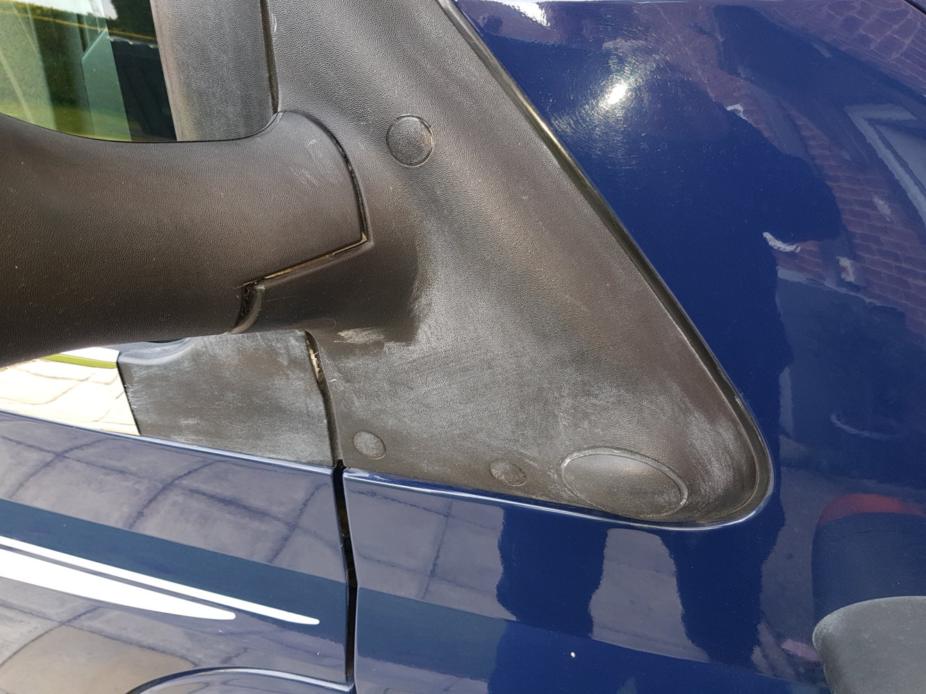

My black trim has got white patches all over it, any tips on removing? I've tried back to black and others but none seem to work.

It's polish I guess and I've never found anything which will permanently remove it but a bumper treatment will cover it for a couple of months.

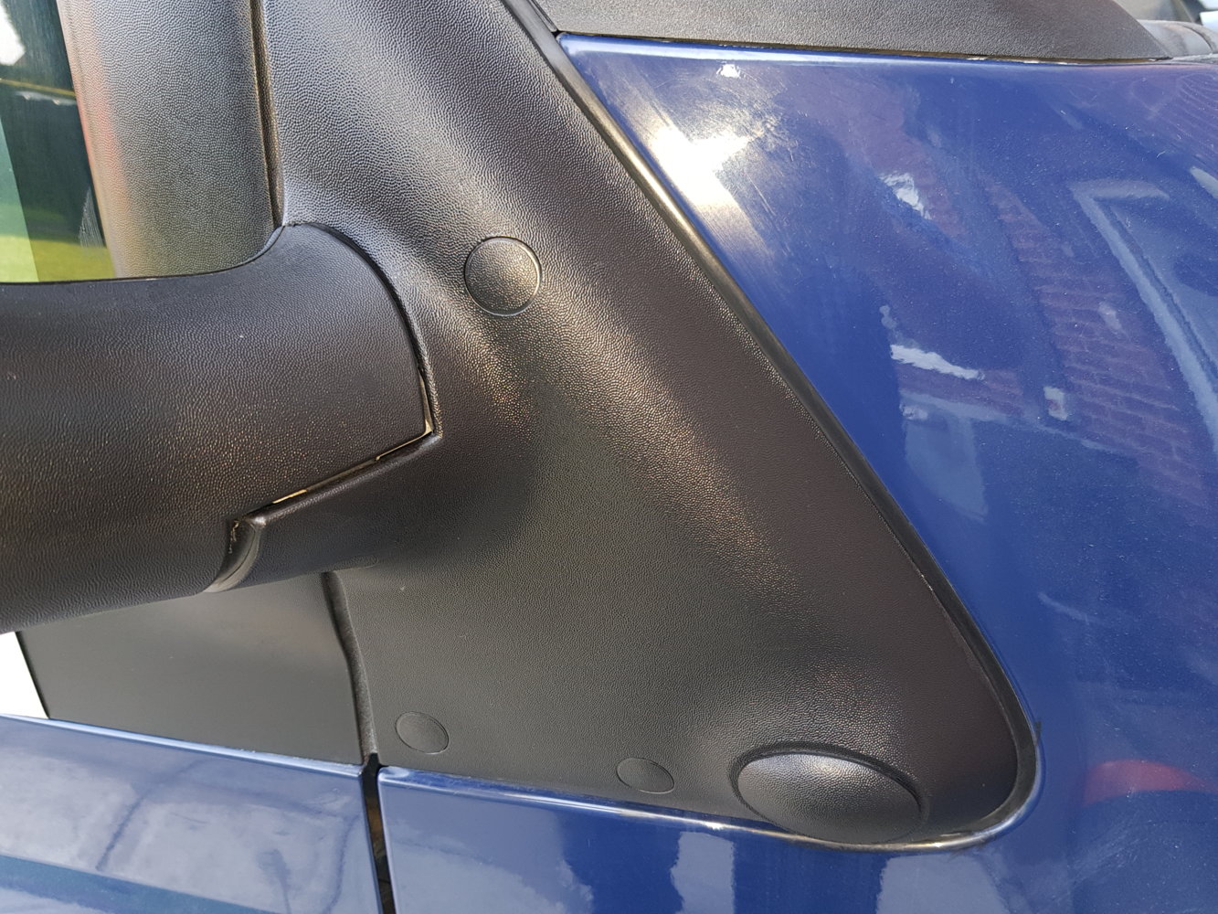

I used Forever Black to tart up all the black plastic trim on our Ducato after read online user reviews and a year on it look like the day I did it.
just applied this to white marks etc on our door handles and have to say im impressed so far!!

I used some Forever Black at the weekend. Stained all my water marked mid-grey plastics to a solid shade of black. Took a couple of coats to get rid of all the marks and sun damage. Van looks much neater now. We travelled back through some torrential rain at the weekend and did some back-lanes with plenty of undergrowth smacking the mirrors and bumper. Still nice and glossy black, so better than Back To Black!

I tried the hot air gun approach. Heated it enough so the surface was glossy and soft enough to leave a small gouge where I gently touched the end of the heat gun against it. It did make it look better, but it was still patchy. Maybe it's more effective with black plastics than the mid-grey on my van?
