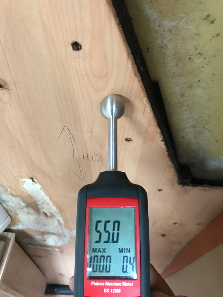

As I mentioned in the previous post, we've had large parts of the roof resealed. It's hard to tell whether it's still leaking at all as the plastic & foam covered headlining makes it near impossible for things to dry out on their own. So I'm taking it all off and will recover the ceiling.
We have four main areas of damp so far to my knowledge:
- Overhead cab/hab join + poorly fitted 4G/WiFi/GPS antenna
- Both wall areas behind the cab/hab joining rails & around windows
- Overhead area over the bed / kitchen (awning rails maybe?)
- Garage wall closest to the large hatch (possibly caused by seals as they seam quite common?)
The plan is to strip the interior down to the wall panels (or delicately to the frame if the panels are visibly damaged / have high readings) from front to back and asses from there, I've started and what I've uncovered is not pleasant viewing...
Past owners have obviously not dealt with progressing issues, completely obscured them from view by fitting new cupboards, lights and even just wallpapered over the visible areas. These are tell tail signs I suppose, shame I missed them!

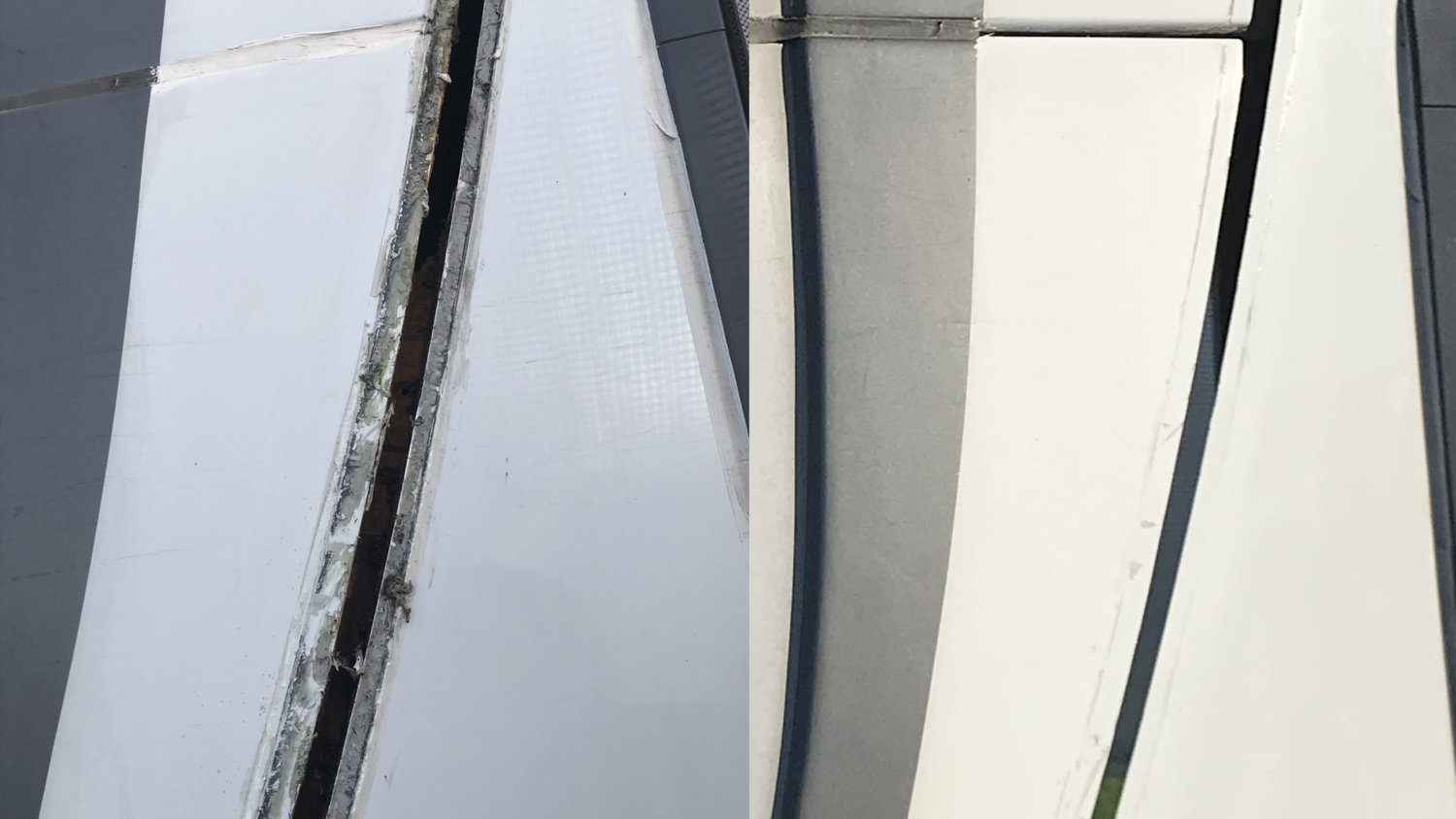

Before and after shots front of areas... a submarine would probably have less damp than we have at the moment. I'm preparing for rot under the lower mid sections, nearer the floor seems drier which is a bonus.

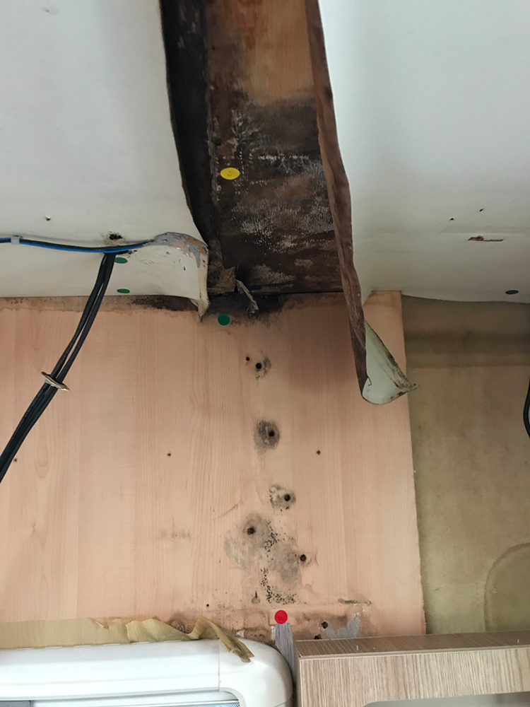

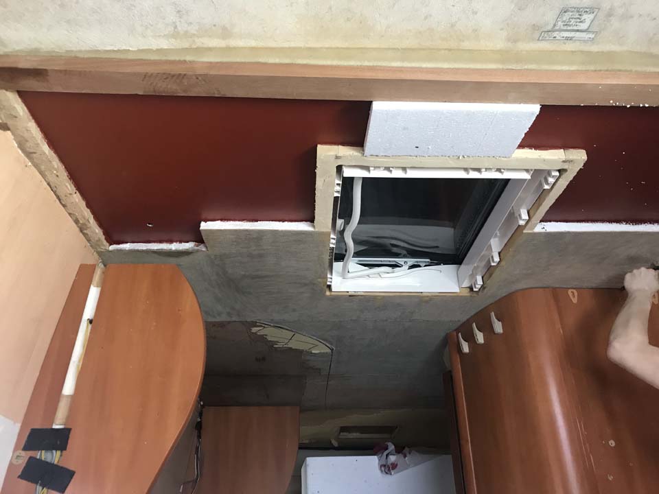

Slow one today, I got hung up trying to remove the cupboards above the kitchen and had to go shopping for an angled screwdriver to get at some interestingly positioned screws. Once I had removed the cupboards I was met with more damaged roof panel. Finding this has cemented the decision to remove everything on the roof and reseal the lot.
Also, started removing the bench under which the fresh water tanks sits, another fiddly one as it's hard to get to certain screws to remove the surround due to the tank being in the way, but you can't move the tank without removing the surround! Got there in the end though.
So tomorrow I'm draining her down, removing the water tank and Gaslow system before starting on on the kitchen unit.
Some shots of the damage found above the kitchen cupboards, the boards are in a pretty bad state, de-laminated ply and water damaged padded vinyl...

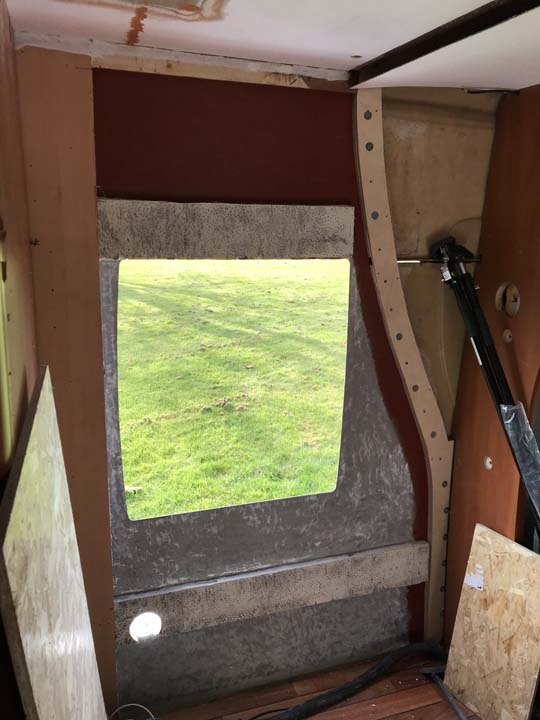

Time for an update! It's been a slow old slog removing internal fixtures, bagging and tagging the fixings but I'm getting there!
I've stripped back a channel along the bottom of the driver side wall and the cab/hab joining rail to assess how far the water has got (turns out a long way). The entire rail has been leaking badly (as well as the antenna above it), the water has run down the join and sat along the main horizontal floor timber (which was wet but thankfully not rotten). Also, started cutting down the horizontal ceiling and wall supports to try and find some good wood!
The outside joining rail removed:
The rail is screwed in from inside and held in place with a 30mm ply strip, this was so badly rotten and damp it disintegrated into small bits during removal.
Removing the leaky antenna, roof rack rail & cab/hab joining bar:
The vehicle has clearly had work on this side, except whoever put it back together didn't take the time or couldn't level/line things up! The GRP fairing / aluminium roof joint has about 10mm height difference on the drivers side, that was filled with sealant. I've checked the lower half of the vehicle is square, roof strike on this side at some point?
As it's going to be another nice day today I'm going to finish cleaning the sealant from the surfaces and get the roof and moulding lined up properly ready to rebuild the internal structure.

Long overdue update, hope everyone's safe and well!
With all of this sunny weather and the 'lock down' in place, I've had more time to crack on.
Finished cleaning the cab/hab jointing area and painted ready for the new jointing bar to be bonded over it which has just turned up.
I've stripped all of the old board, insulation and glue from the first roof section leaving just the thin aluminium skin. Warning to others, even after 6 weeks with a heater and dehumidifier on 24/7 the deeper insulation was still very wet.
I've also cut out all of the rotten structural wood and replaced it with hard wood. Owing to the current circumstances I was unable to get treated. (Note that it was placed in the photo not screwed and bonded so there are a few gaps!)
Before bonding the new insulation I painted the skin with metal primer to protect it and provide a good surface for the new contact adhesive to bond to.
I decided to replace the insulation like for like, in my case 30mm EPS (Expanded Polystyrene). I did think about using Kingspan or Celotex, but was concerned about using a completely different material with different properties for no massive gain.
The insulation was bonded into place with some contact adhesive (Reactacure 1835) recommended to me by Glues Direct that has a low solvent attack on EPS insulation. I'd highly recommend these guys, very helpful and knowledgable as what to use to bond various substrates.
Aluminium plates (0.75mm) were also bonded into place to provide reinforced hang points for the cupboards that will be mounted there.
Finally, I re-boarded the section using 3.6mm birch ply bonded using the same contact adhesive as the insulation. You can see below that I have also added a wiring channel just behind the support member so I can run cables from one side of the motorhome to the other, the holes will be in cupboards.
I've remade the side cab/hab jointing rail supports (curved wood on the right hand side of the second photo) out of sections of 12mm & 18mm ply bonded together as the manufacturer did. I scribed round the joining rails and added some for good measure.
I've followed the same stripping/painting process for the N/S wall and reinstalled the joining rails with Sikaflex 512. By the looks of it, they've failed multiple times using non-setting bedding sealant so after speaking with multiple technical departments of the sealant / adhesive manufacturers I decided to go with this option.
The forward forward boards above the cab area have been replaced as they were also partly rotten... I'm painting the ceiling with bright white emulsion, I think it will look quite nice, it'll also work out much cheaper than using m/h roofing board and will allow me to blend existing ply that's ok :giggle:
