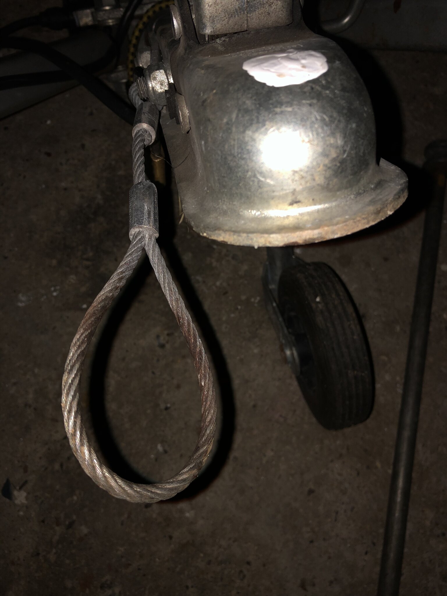

Its hard to tell from that angle but is that an un-braked pressed steel hitch
Yes if you read my posts above I have an in car powered auxiliary braking system so do not require a braked hitch which is also the case with other similar systems.
Minxy Girl your a star.
The only one whos come close to working out the emegency braking in an electricly braked A frame.
And if fitted to the car in question would have applied the brake

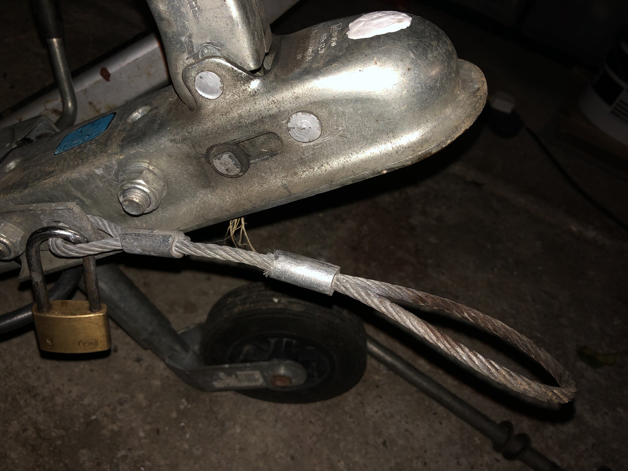

Lenny secondary cable is ideal as described and fitted BUT that is most definitely NOT the place to use as a main breakaway point
All the extra cables and chains suggested here would not have helped if the frame detachment happens at the car end.
With the RVi brake unit similar to Brake Buddy if the a frame detached from the car the breakaway cable would pull the car mounted switch and power up the brake unit.
I accept your explanation of the system, what I’m getting at is your hitch *looks* like an unbraked pressed steel hitch, which only has a 750kgs limit
It is pressed steel unbraked and 1400 kg.

Been into the garage , photos as promised, the cable was fitted as standard by Towtal.
View attachment 553070View attachment 553071
& as I stated above the shortness of that will doubtflly allow operation of the breakaway fnction to operate the brakes.
Larrynwin That cable is the same as mine but mine is much longer (not boasting or anything…)
Which would be better but surely drags on the ground?
but only meant to be used on unbraked trailers up to 750kgs.
