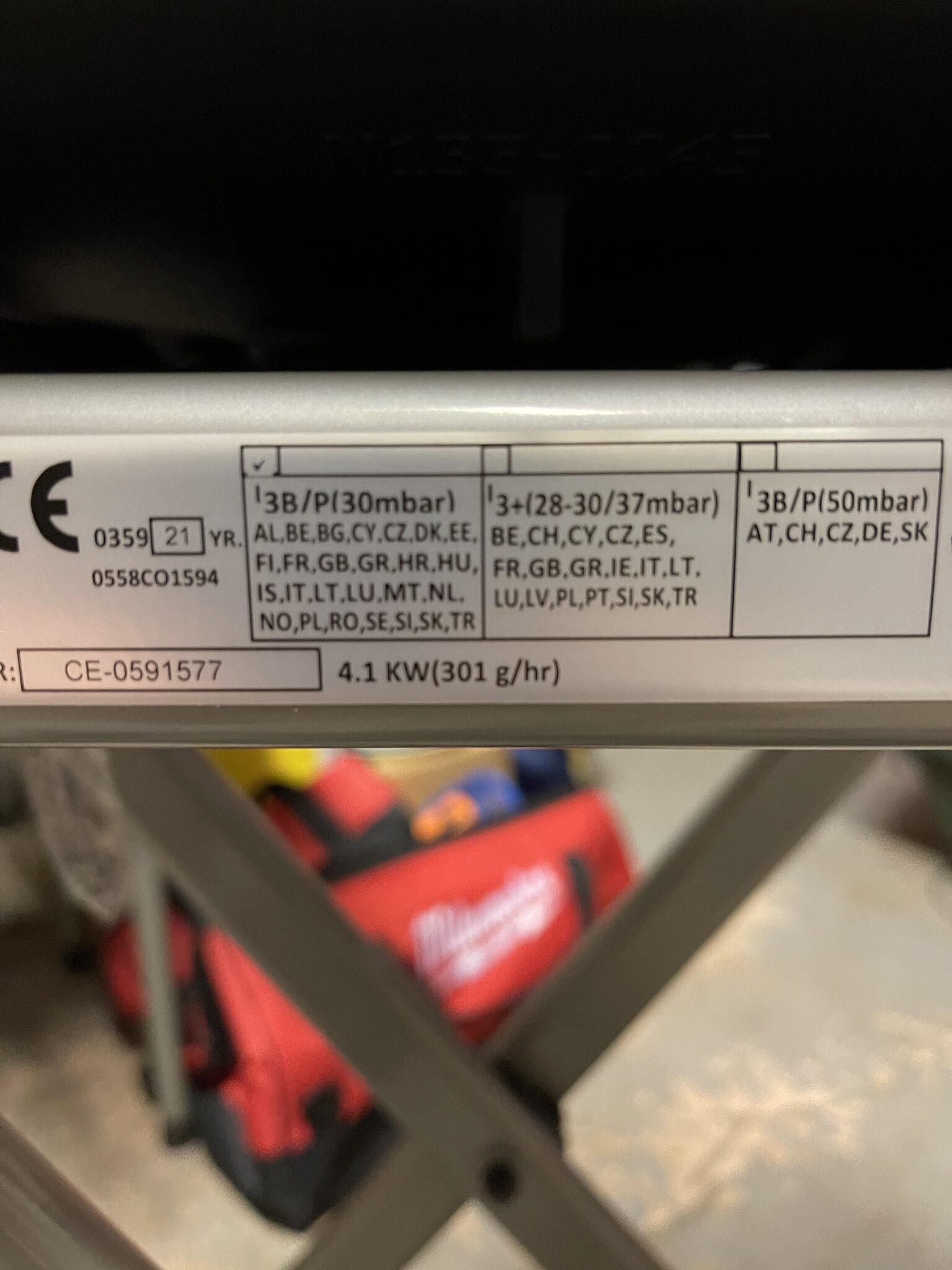

Does anyone bother to check which gas/pressure the BBQ they are thinking of buying is designed to run on - and if it’s compatible with their onboard MoHo regulator?
Examples from manufacturers published data (which should be on the appliance data plate):
I3+ - 28-30 / 37 mbar (butane 28-30mb & propane 37mbar)
I3B/P - 30 mbar / 2.8 kPa (butane & propane 30mbar)
The wrong match - an I3+ BBQ running on propane from a 30mbar regulator - just might not provide the temperature range expected (which seems to be a somewhat common occurrence in lower ambient temperatures ;)).

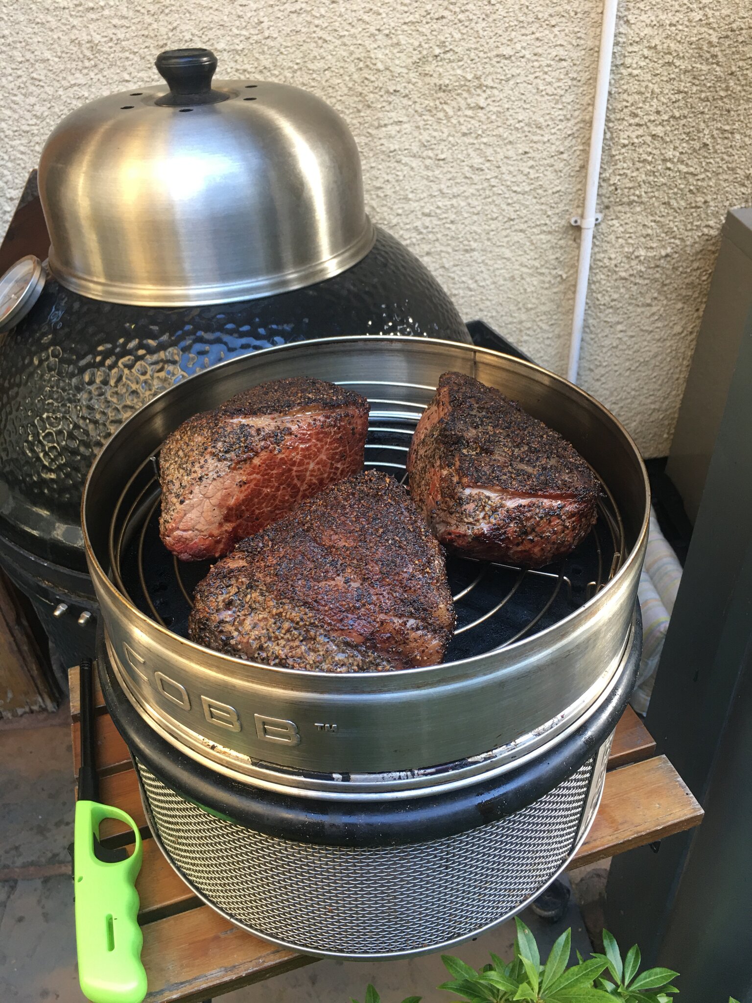

We have a Kamado under cover in the backyard and use it year round and almost 100% when at home during the allegedly ‘warmer’ months. When outdoors/camping the Cobb is the weapon of choice - very versatile and initially expensive but we’ve had it for years and have certainly had our money’s worth out of it - and nothing comes near it for a piri piri chicken, Picanha beef, or smallish leg of lamb on the go.
Recognising the limitations imposed on naked flame cooking in certain places, I bought a Napoleon TravelQ 285X with griddle plate and smoker tube, which has been in use on a standalone propane bottle. It’s a relatively large unit but again, we intend to keep on cooking outdoors as much as possible - both BBQ and a la plancha. I wanted to ensure the BBQ and MoHo gas supply (when it eventually arrives!) were compatible, so I had a good look around a dealer demo model shortly after ordering while sizing up for the Alugas installation and saw that the Truma regulator is rated at 30mbar. Luckily Napoleon have units for the GB market rated for both 30mbar and 37mb (see data plate below) so I went for the former and changed the regulator on the bottle to suit.

My god them fillets looks a bit good, what time should i come round:LOL:(y)
You’ll have to join the queue! :ROFLMAO:
We’ve two grandsons who would do serious cutlery damage if anyone tried to jump it.
Picanha (peppered rump) cuts available pre-packed from the Morrisons meat aisle - sear all round and then indirect heat and smoke in the Cobb for around 45 minutes - good value and none of us have had anything but empty plates.
