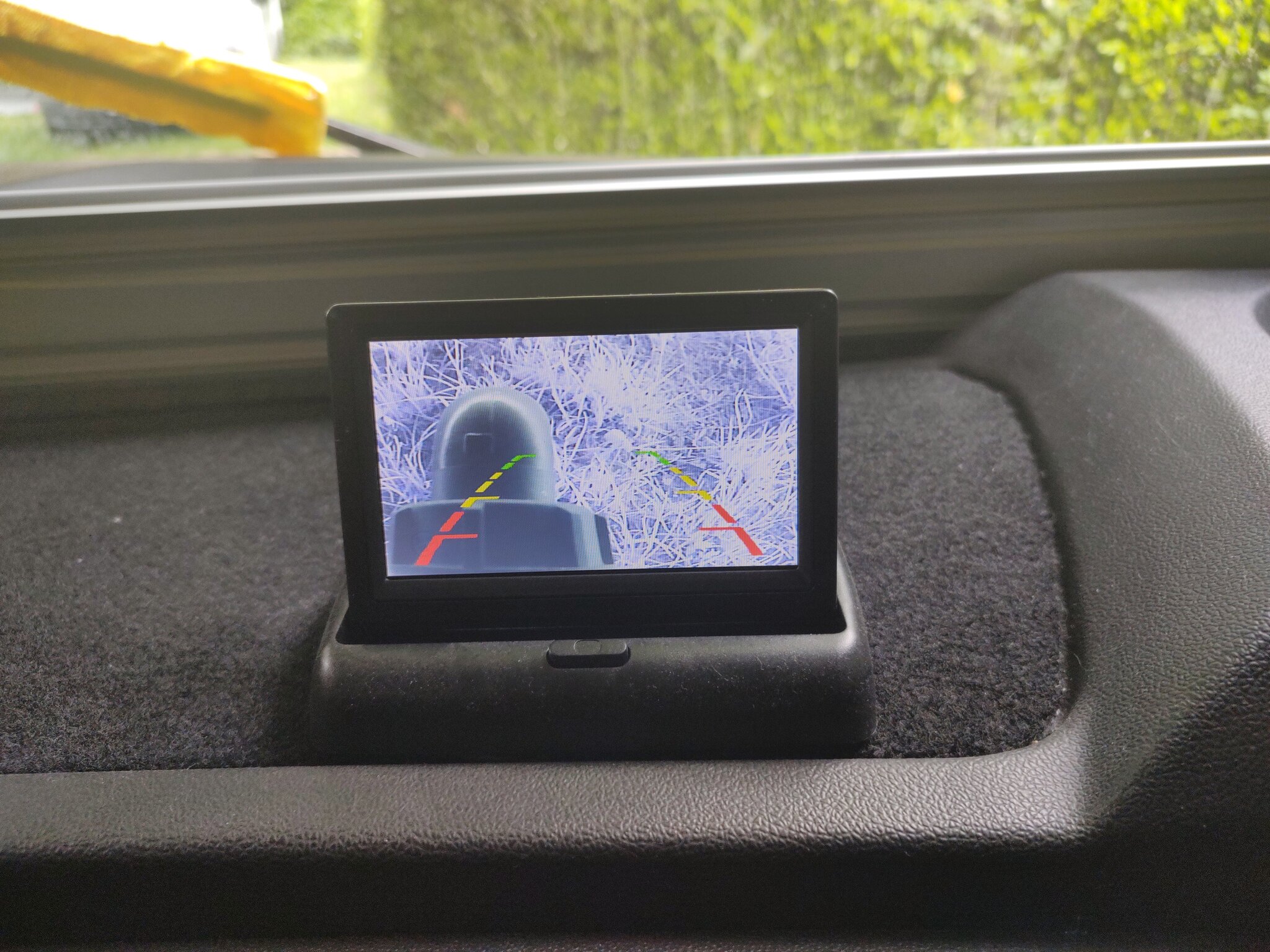

We bought a camera and screen from eBay for £25. The advert said 'explosion proof camera'!!
Just took a feed from fuse box under steering wheel. Threading wire was most difficult bit. But now so easy to drive/ reverse over drains. Had for last 10 months and haven't needed to clean the camera yet. Fitted small switch and camera folds down when not in use.
Also good for spotting stowaways when leaving Calais for the UK! :giggle:
Yes you're spot on. There's room for about ten below deck::bigsmile:. Should've said screen, not camera, folds away.
