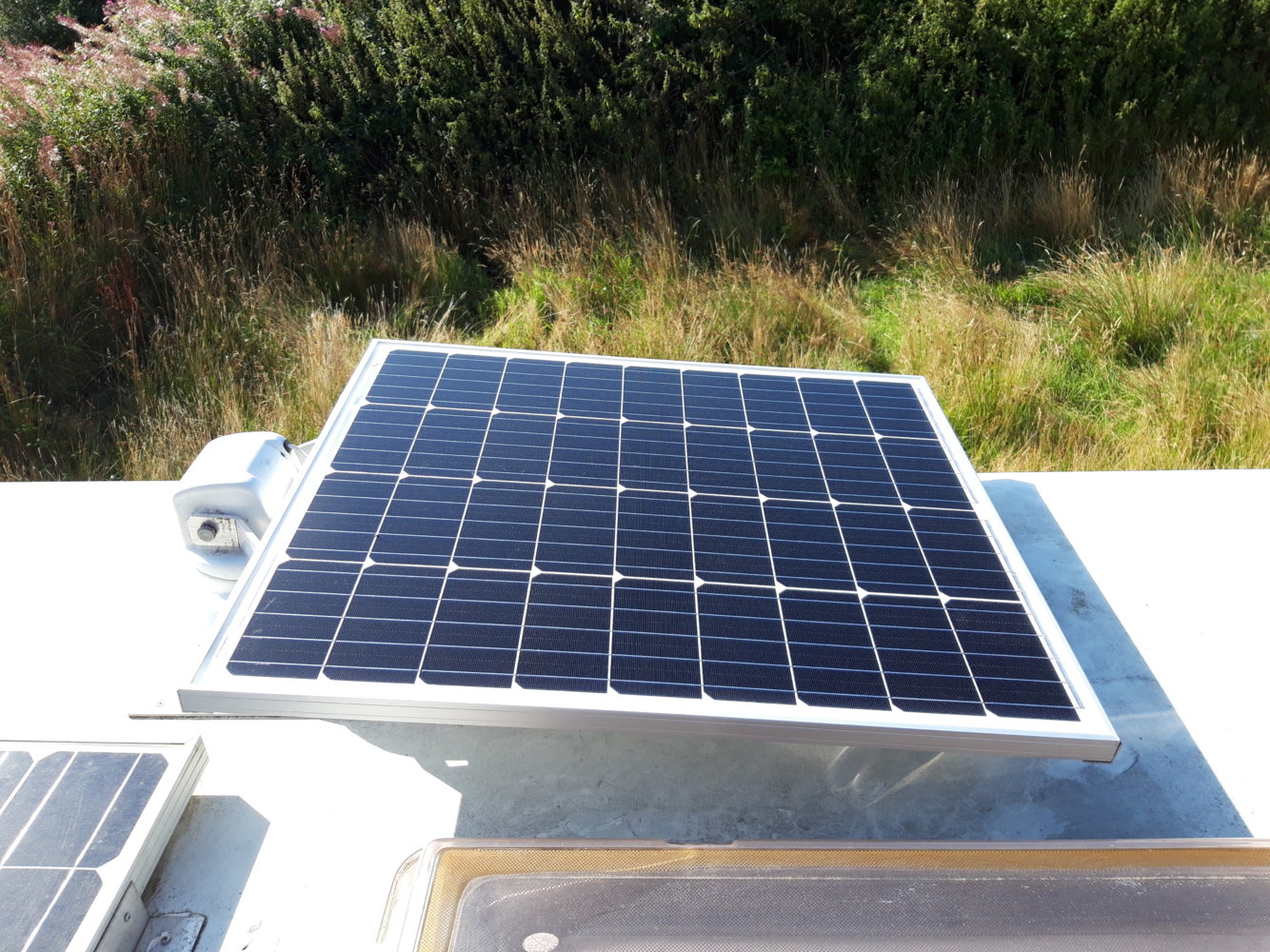

I made our panel capable of tilting.
In winter, what would be 2 amps flat, goes up to about 7 amps tilted ?
Damn, that's a clean roof!! Guess I'll have to clean mine soon. ?
I also turned one of our panels into a tilting one, we usually park with hab door facing South, so get pretty good results.
Note the dirt. ?
