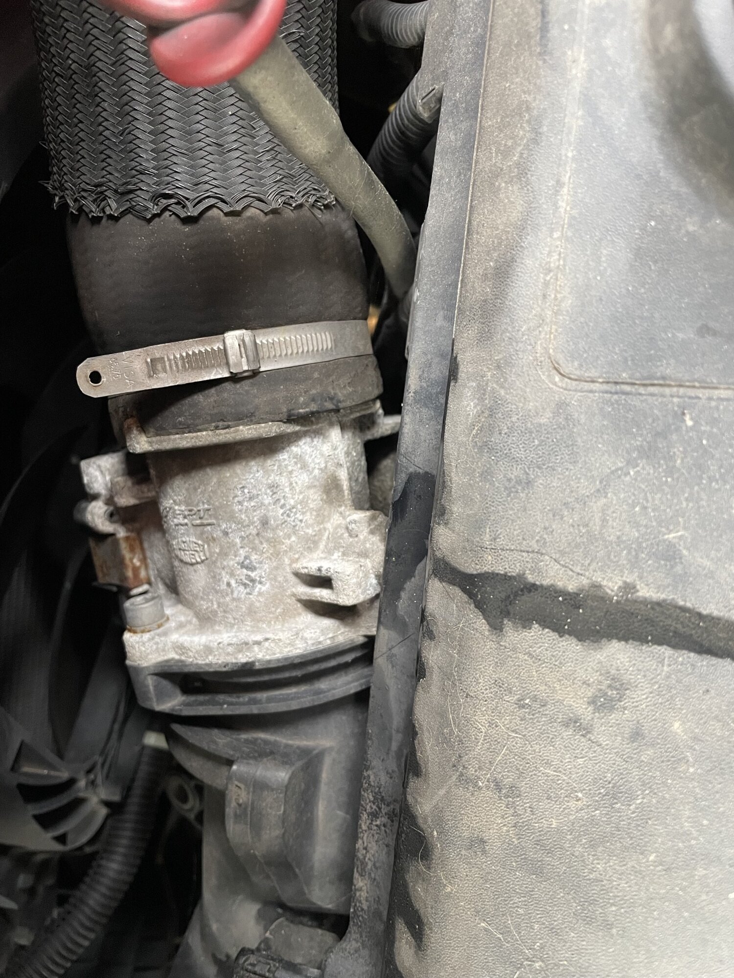

Put a picture on of the throttle body any I will tell you if new or old.
As is said before you can just remove the air intake pipe and see the flap of the TB. If you have the newer one you can also buy/exchange parts of it. The old style you couldn’t and had to change the complete unit. And that is a complete pain.

Landy Andy photo below. I also have noticed that there is water coning through and running down onto the TB.

You have the newer and better version made by Magneti Marelli. Si if required you can swap parts about rather than dismantling front of van and having to remove entire unit, which always involves the bolts breaking in the cylinder block.
You can remove the rubber pipe attached to the TB on the left and then, probably with mirror, look through the TB and see what the TB valve is physically doing. It should be fully open (95%), and then when you switch of engine it should shut to 5% stay like that for 1 min then open again.
Water running across can obviously cause problems with the unit and it’s connection’s.
I’m near Hertford. Shout if you need help 👍🏻
