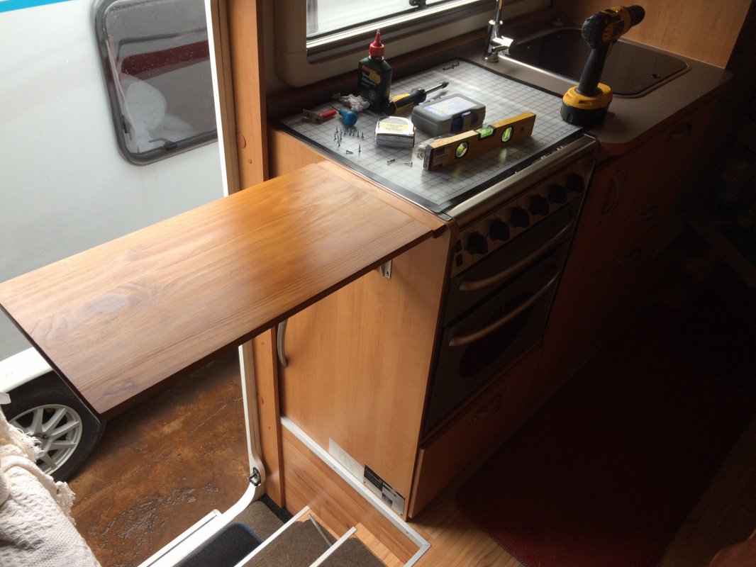

hi all,
I thought I'd share my handy work with you.
With exception of the dinette and rear table (U shape rear lounge), my motorhome like many, has limited worktop space.
The hob has a glass lid cover, as does the sink, but hardly any work surface between. So I've made a folding worktop.
I bought a Pine shelf kit from B&Q and after testing nearly every colour of varnish, oil and wood dye on the shelf brackets, finally decided on antique pine as the nearest match to the internal fitted Memphis Cherry woodwork. (@Techno100 - your prediction of antique pine was correct!)
So, four coats later on the actual shelf and it looks a good match. Shelf brackets no longer needed.
I bought a Rakego folding bracket (used on boats for space saving) as the support bracket and used hinges between the shelf (now worktop) and a baton screwed and glued to the side of the oven outer wood wall.
With some trial and error positioning, I've managed to get a strong, stable and level worktop.
The Rakego is rated to around 60kg for a spread out weight on the worktop, which is about just right for my wife's Desperate Dan cow pie, so I'm sure we won't be having a disaster of the plates going through the floor when it's dished up!
All I need to add now is a rubber door stop/bung to the underneath, to keep the worktop vertically straight and protect the Rakego support screws from pulling out when collapsing down the worktop when not in use.
Photos as per below.
Let's hope gas doesn't escape via he screw holes from the oven! Ha ha
Nice job - I'm not sure I would have made it so big though as I'd be wary of putting anything heavy on the end part past the where the support arm stops which could cause a leverage effect and pull the screws out of the hinges as that will be your weakest point, not the support bracket itself.

"Neat"..............(y) The only thing I would do is put a nice neat bit of edging on to stop things being slid/pushed off the edge..

Thanks Minxygirl
The end edge beyond the support is designed to take 30kg and as part of the design, the baton is required to help counter balance the worktop and avoids the worktop pulling out the fixings/screws. It's all in the design ( Rakego on YouTube)
I looked at the brackets like you've got but didn't want two supports when one can do the same job. Plus without the baton, there's a gap between existing worktop and the folded worktop, which I personally didn't want.
Each to their own I suppose.
