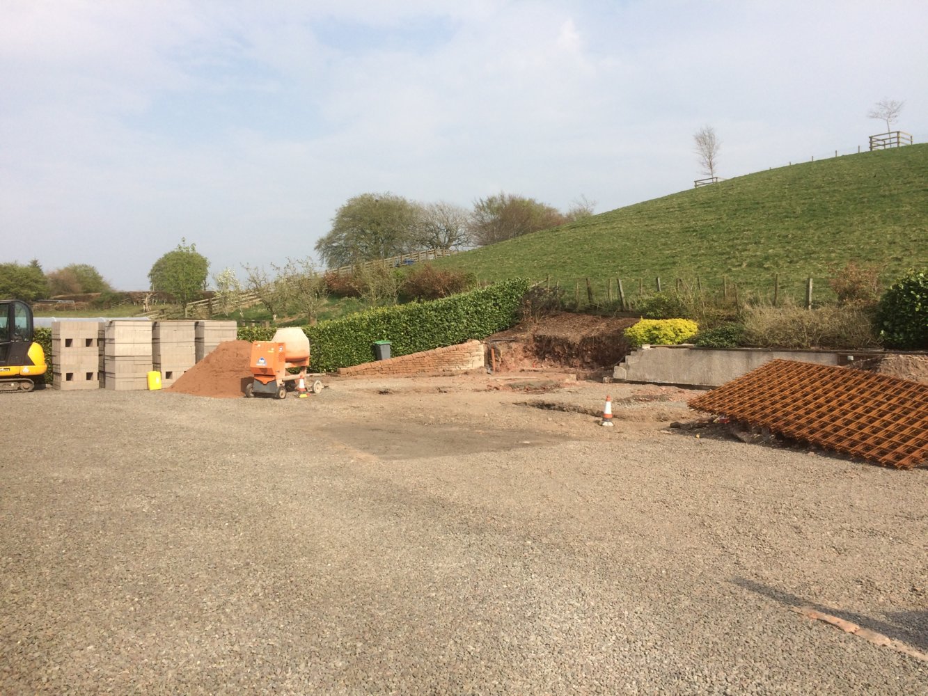

After years of umming and ahhing about whether or not to build a garage/workshop we’ve finally bit the bullet and decided to give our motorhome an easy life and keep her out of the scottish weather. Building will be in two parts......a garage for motor home (5m x 8.5m) and second part a smaller garage come workshop (7m x 6.5m). After eight weeks at planning followed by four weeks at building control we finally got builders in.
Took us ten years to make a garden which we removed in six hours by digger. We’re back to where we started ten years ago!
Foundations dug and about 30ish tons of soil dug out. 5.5 cubic metres of concrete
poured in today and brickies in tomorrow to lay first course of approx. 990 concrete blocks.
I would have sloped that soil bank to 45°.
Save it collapsing onto the garage wall later and causing damp ingress problems.... Or do you have a plan?
Plan in progress.......structural engineer recommended gabions filled with stones.....it’s almost solid rock and gave digger a bit of a hammering to get it that far back......then graded to top of gabions.

There is a rhoddi........first pic, big red flowers!

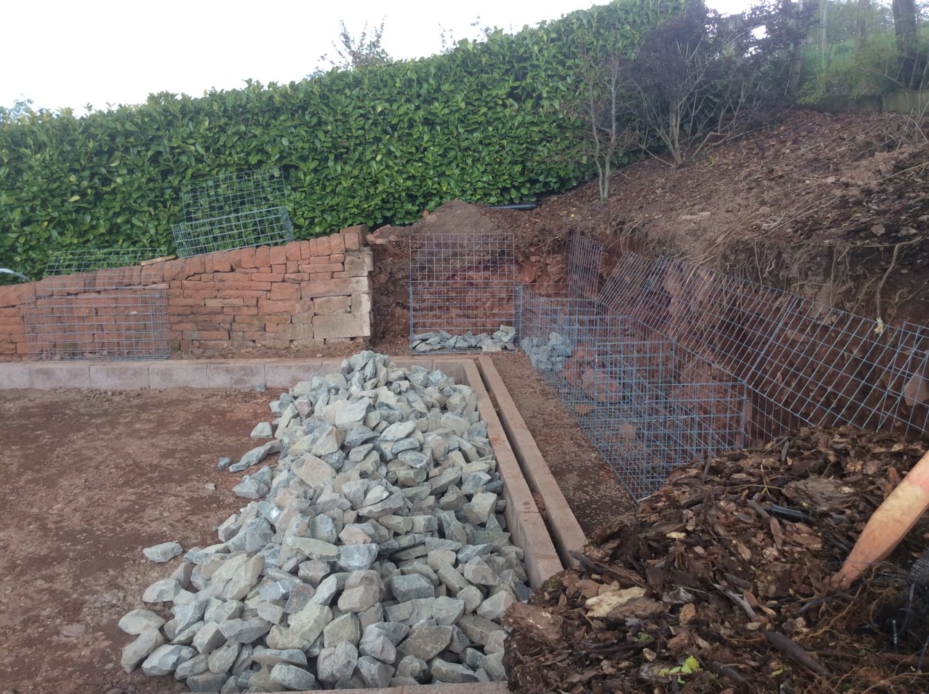

Week 2
Builders back after a few days hols.
Gabions built for retaining wall along with 10 tons of gabion stone ready for filling.
Drainage pipe for retaining wall dug in. Founds backfilled.
Floor scraped back and compacted ready for hardcore.
Retaining wall gabions filled with stone and backfilled soil/rubble......I know my backs been working! Second row tmow.
Kerb laid between garage/workshop.
Hard core laid, compacted and damp proof sheeting laid.
Another 20 odd ton soil/rubble away.
Been a busy day!

Gabions now filled (bar one which wasn’t delivered). Built up sandstone wall.......doesn’t sound much for a day but......
