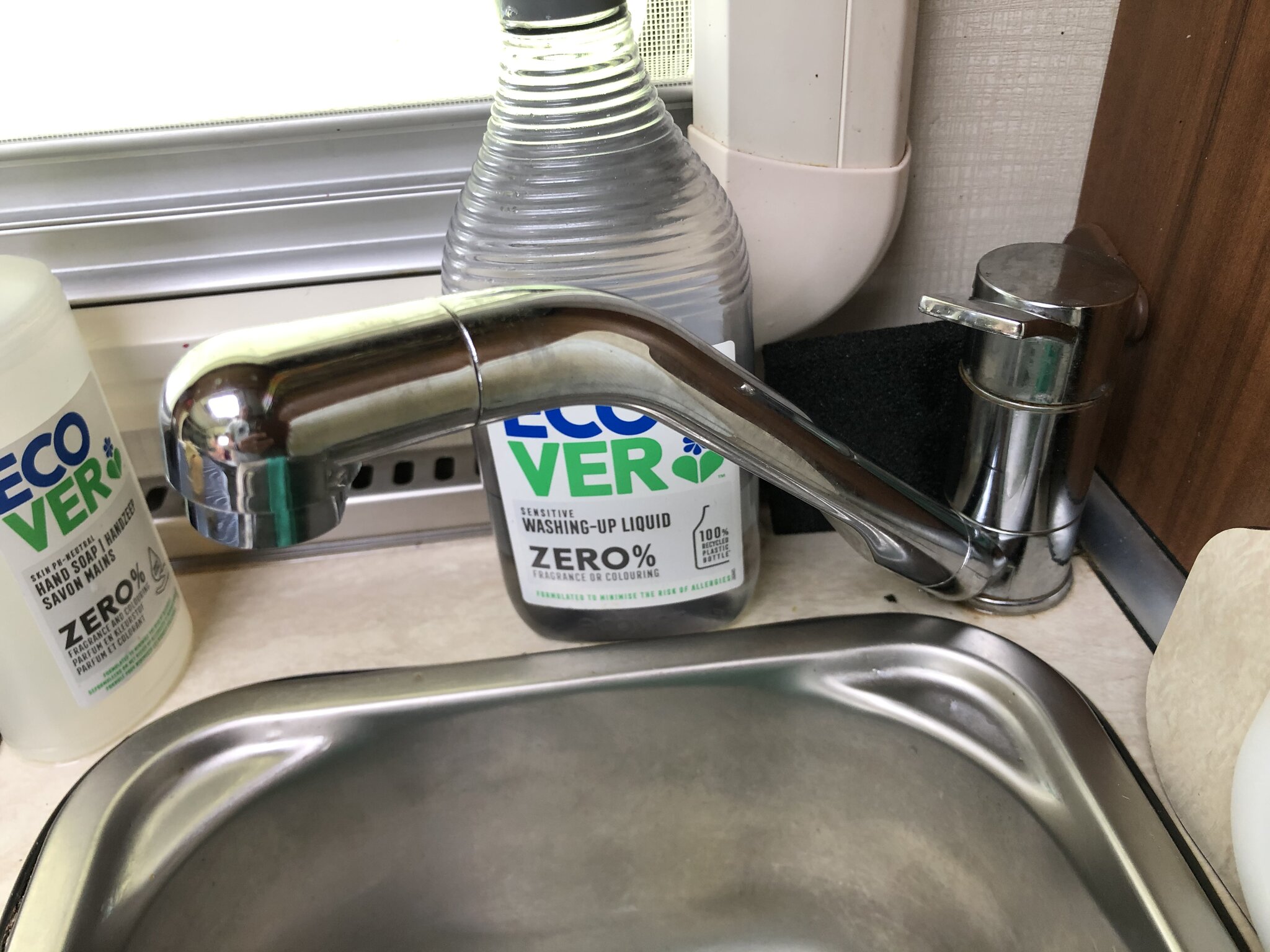

My kitchen tap spout has stung a leak. It is a simple push on pull off spout so looking to simply replace it
Can you buy just the spout ? Are they a universal fit or do I need to find tap make and model number?

If it is leaking from the joint an inch or 2 from the head then you may just need to unthread the head piece and replace the O ring. If you cannot unthread then it will be a new tap. Next question then will be wether it has a micro switch fitted, check under the tap/work surfice, if it does then you need replacement caravan/Motorhome tap unit, if not, then any domestic mixer tap you fancy should fit.

Don't hold me to this but it's very doubtful you can buy just a spout.
New tap is easy enough to fit even if over priced.
I have seen one on Amazon but doesn’t give diameter etc, hence the question about universal size

Ours is a different tap but when we had a leak (earlier this year) from the swivel joint in ours it was a matter of disassembling the tap in situ and replacing the ceramic cartridge inside.
There are two standard sizes as below.
Have a look here.

We had t with our reich tap spout splitting along the mould seem near the joint onto main body (push fit) this happened twice, so bought one similar to this which is all metal.
You would need to check the length.
