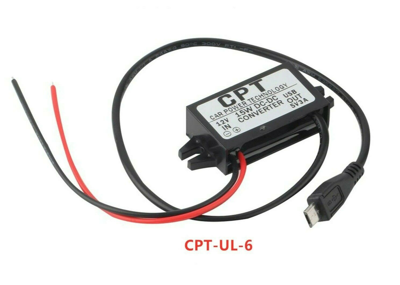

Good day to all, I am about install (DIY) a 4G/LTE system into my PVC, it will be a external roof mounted MIMO antenna from Solwise and a Router in the Van. Target price on the Router is <250 GBP, I already have a Data only sim.
I have some questions on the Router choice, I note some lack of clarity (to my eyes at least) on the specs so any info from the forum members who have fitted a similar setup is appreciated, my questions are
- Router will have its own battery, I note they are supplied with a charger for 100-240v, how are you charging the Router battery from the 12v van battery, is it like a phone setup with a small in car type charger running at 5v output, if so are there any recommendations as to what has worked well with the routers you have?
- Router choice, are there any recommendations on the Models (Huawei/Netgear/Other) and I am thinking it will be models produced over the last two years for current availability?
- Mobile Router types, its not clear if all models have the double external antenna connections (SMA/TS9/TS5), the specs do not always identify that. Is there any advice on models that have proven to be reliable and have the external antenna connections

Morning, if the router has its own battery then try to get one that will charge from USB cable. It is then easy to charge and doesn't need a proprietary charger.

Phil748 answered the voltage / charging question so its 5V and I have ordered one of those 12v adapters today and will plan my Router choice around USB access for charging etc.
