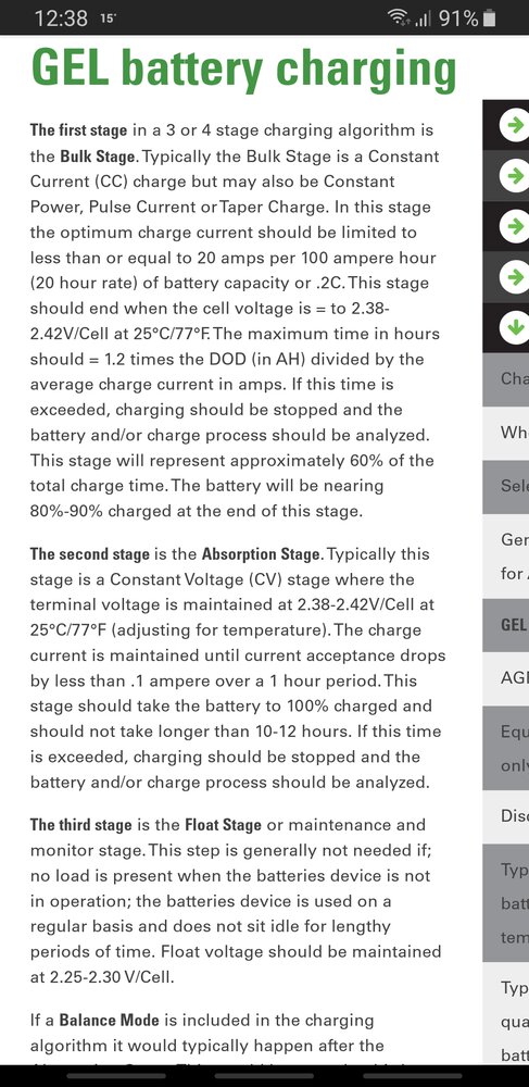

Been Googling and reading about it and a few companies say this...
This one says gels should be held at 14.4v for hours "no longer than 10 to 12 hours"
Is this from a particular battery charger manufacturer or a technical document ? I too have read that a Gel battery may have to be held at 14.4 V for a longer period than a Lead Acid battery in order to ensure it is fully charged and I think this is well understood within the Battery charging industry.
