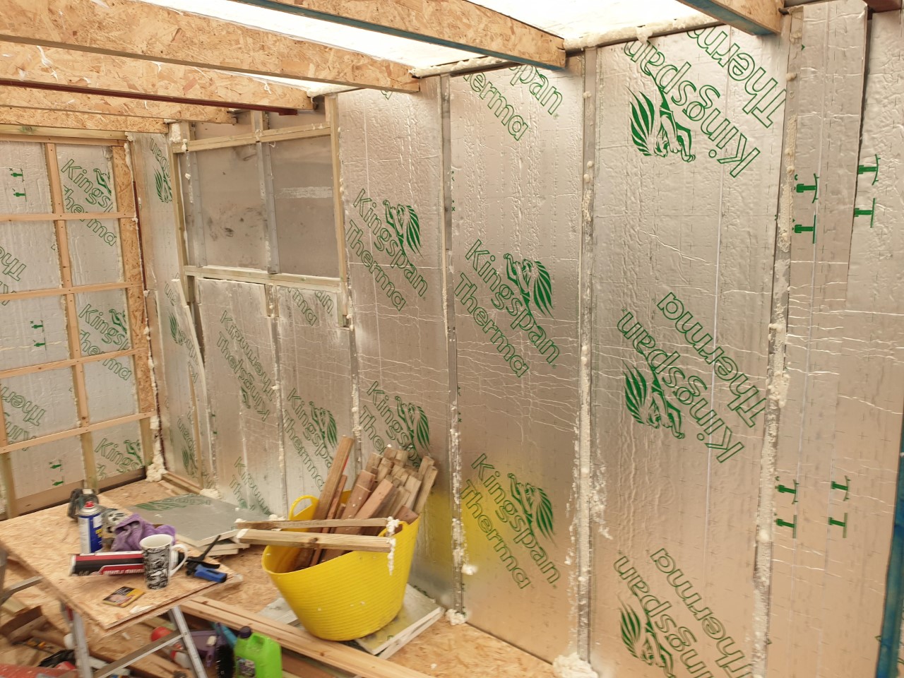

Spent this week finishing the insulation theres enough silver foil tape in there to satisfy even the weirdest aliens are talking to me people. Sorted the locations for the aircon units, rooflights and solar panels. once the strapping is finished its time for the wiring.
Love the stealth windows :giggler: .
