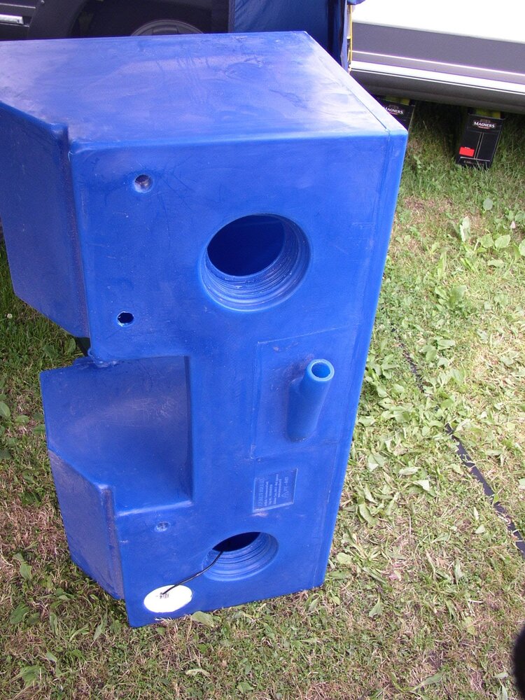

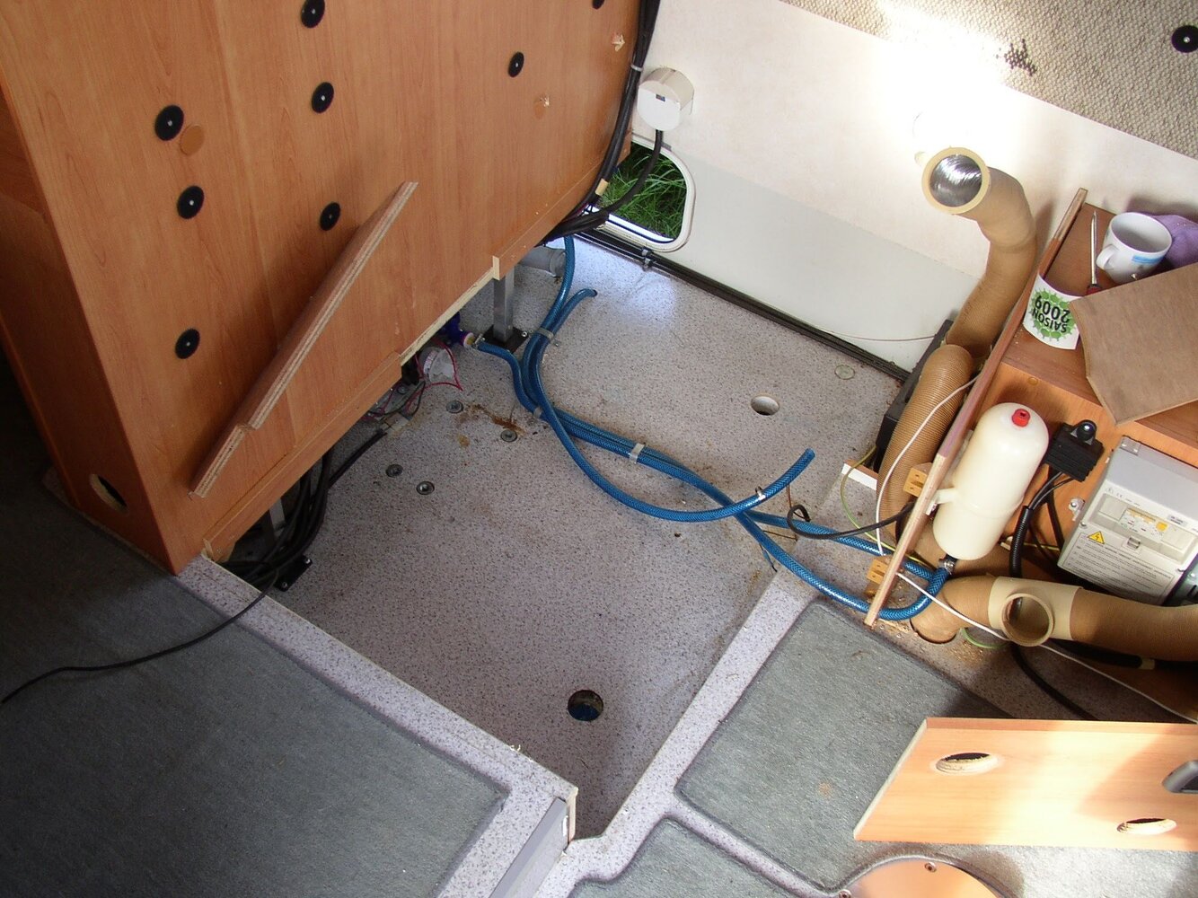

We took ours out of our eura mobil, because the seatbelt frame weighs over 30kg and only held one seat belt that was never used, 😉 we then did it all again when we sold it. 😁 Bob

Great skills, fair play 👏👍. Now that you finished the whole process, did you find any part of the process difficult or was it a case of being very methodical? When you were putting it back together did you replace any of the hose work? Cheers for your response 👍
It was easier than we expected, considering we had done the factory tour and seeing the chassis come in for a class build with only a box to sit on, 😉 and one of the first things to be bolted to the chassis was the part we took out. 😁
All the hoses were fine, I can't remember how long it took, but not that long because we was living in it, and were animal sitting 10 cows 3 horses and two dogs for Roger ex fun member wildman in a field near Ilfracombe. 😁 Bob.
