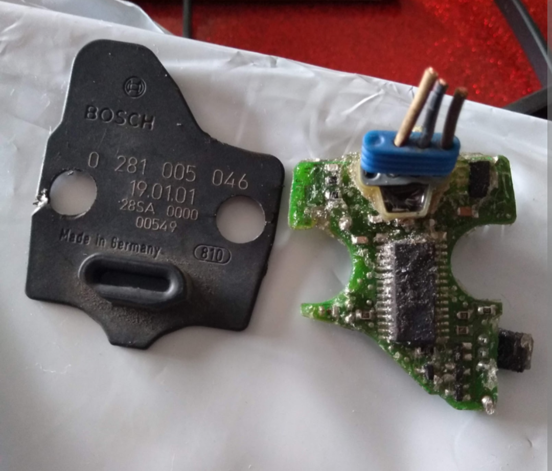

Many auto electricians try and fix replace the ECU or the immobiliser unit but often best method is to cut the old immobiliser out altogether.
If you have the Orange "Key Code" light illuminated then don't waste your time trying to start - it won't until the light goes out.
There is a small circuit board bolted to the fuel pump at the front of the engine and this can be cut out by hand (takes time and sharp chisels) and a new 12V live feed wire simply run from battery to pump. This all assumes it is the same as my old 2.5TD Ducato engine.

Hi thanks yeah I've had the intermittent orange key symbol for months which will crank but won't start. Would you be able to put a pic up of where this should be located please ?
And once found your saying simply cutting it out and putting a 12v live from the battery ro the fuel pump will resolve the issue. Is that then essentially bypassing the immobiliser? Where exactly does the live go to on tbe fuel pump?
