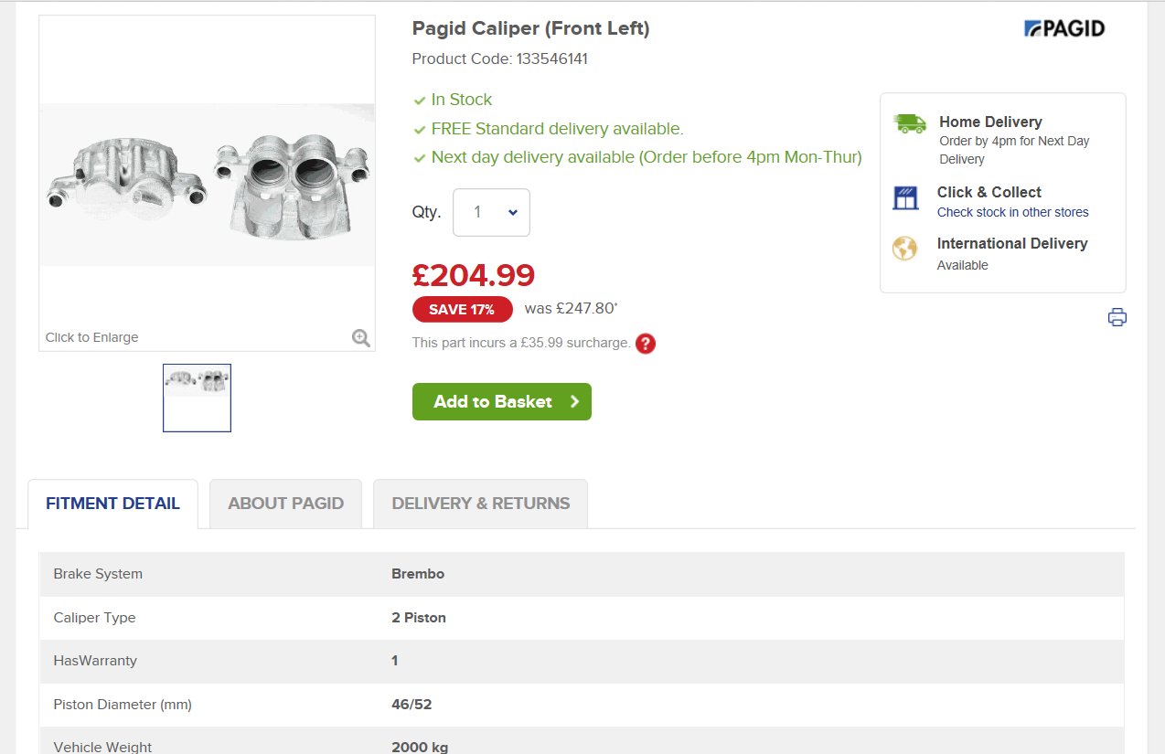

I have no problem buying a pattern one. I've looked at the Euro car parts ones. They don't appear to be the right ones because they're for 15" wheels and the pistons are the wrong sizes. 44mm/48mm as opposed to the 46mm/52mm ones I need. I will have another look though. Ta

Try here
CT14 0LU Ducato_3.0_2009/p/car-parts/brake-hydraulics/brakes/brake-caliper/?133546141&1&c7cbca0ebe3d1cacad4ee31376f70f025b4acc61&000048
D
deleted-member02
Deleted User
Copying and pasting the entire link (not just the highlighted part) will bring this up (y)
