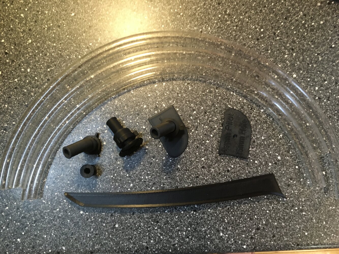

I have been working on a solution to overcome the problem of water accumulating around the base of the windscreen on X250 Fiat Ducato’s. I’m preparing a home made 3D printed kit of drainage pipe fittings complete with suitable hosing. All you will need to fit it all are drills and silicone sealant. Final testing should be finished in about a week. If anyone is interested in my solution, please let me know.

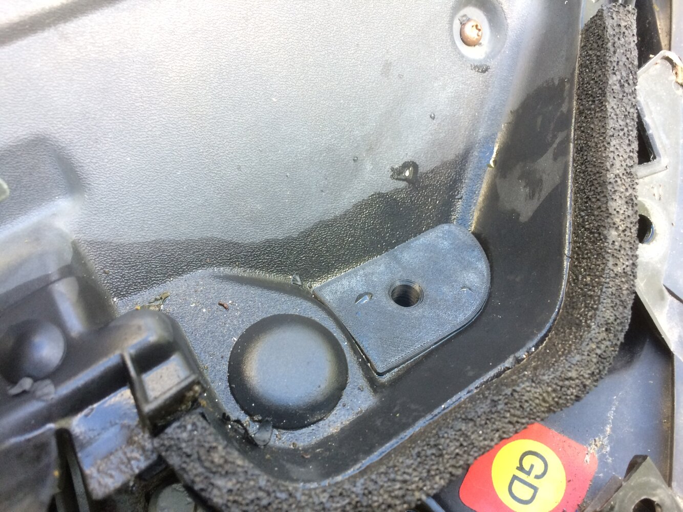

This is the additional drain in front of the passenger. 8mm hole with 12mm hose. Will send more pictures as I test the kit.

Quite possibly will fit. Look closely at my pictures as I post them and judge for yourself.
Update. This is the drain on the passengers side. Comes with a template to get the hole in exactly the right position. Drop the drain into place with black silicone behind it and tighten the nut from behind by hand. Slide the hose on which is included with the kit.

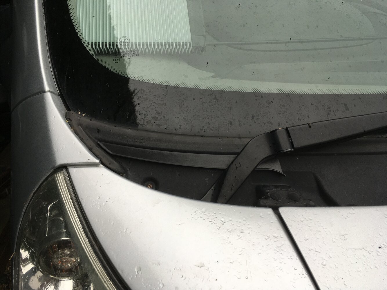

Working on the final one by the wiper spindle. This is the difficult one as there is much space. 👍

Working on the final drain by the wiper spindle at the moment. It’s proving tricky. I want to make it easy to fit, not a nightmare. After 40 years of being an auto mechanic and cursing stupid design, I want to make this easy, not a fight.

The final drain on the RH side next to the wiper spindle is finally sorted. The drain hole on this one is slightly smaller at 6mm as apposed to 8mm in the other drains. This is due to the limited space around the wiper spindle. I have added a deflector gutter to try and reduce water flow to compensate if people don’t mind the little gutter being visible.
CF2A4A8B-07C6-4AC5-A205-EB139775E3EB.jpeg A6775A2B-D69B-443A-9F2D-266B9F9C0AF3.jpeg 0957192C-EE6C-4752-B7BA-A3B560202D89.jpeg 40C0E6D8-9C81-45BA-8C55-7CE3DEB64702.jpeg 7BC1C8B1-31C8-478C-8708-761C2D4A9AE1.jpeg
This will be the final kit complete with hoses.
The items you will need to fit it all is as follows
4mm, 12mm, 15mm. drills
6mm Allen Key
Black Sikaflex/Silicone.
Items that need removing are the panels above the headlights. Headlight removal is optional, but makes the job much easier if they are out. Should be around £25 including p&p. Will you guys let me know if you would use the gutter as it’s not really needed, just thought it might be good idea. 👍. Should have it in the classifieds in a day or so.
