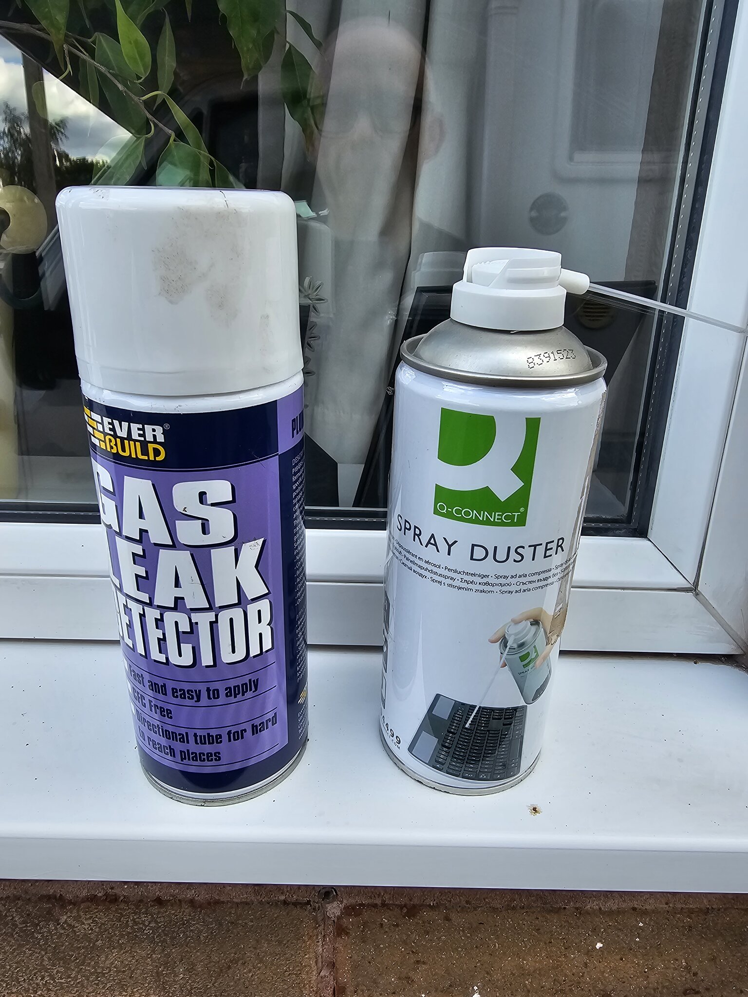

I returned home last night and today after much googling and reading posts on here have used some compressed air to last out the burner and the pipe leading to it.
The gas lights and stays lit without issue. It lights with a woosh. I've attached a video. However, regardless of the rotary temperate setting, the flame size does not change.
I have run it today (12 hours) and it has managed to chill it to a minimum of minus 7.4 degs. However the fridge only got to 17.7 degrees (ambient was 26 degrees).

Got home, removed the baffle (which looked remarkably clean), removed the burner (looks clean), bottle brushed the flue from both ends (probably reached the top and bottom third due to length of brush) and nothing much came out of the bottom or stuck to the the brush... blasted it all with air, reassembled, and it's now lit and I'm watching the temperature, see what happens next 🤞
