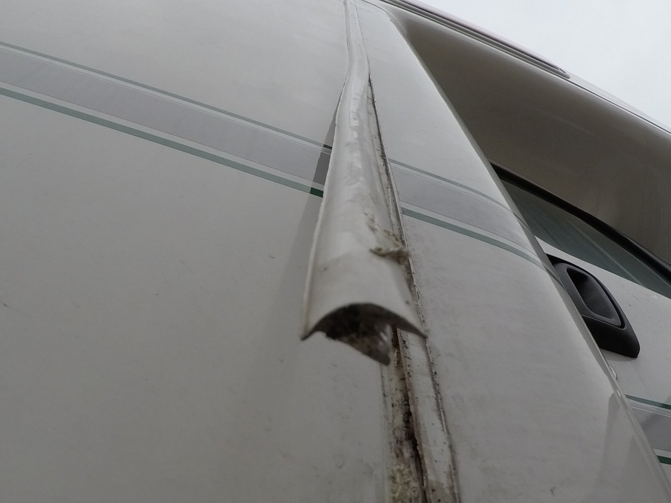

So after the recent weather the MH has bitten back with another leak! Bessacarr E795 - 2006 model
We were away in Bournemouth this week and the weather was horrible, we had Bessie level and went out for the day. When we returned we were meet with dripping water from the front. A quick look on the roof and the water had formed a massive pool and had not been running away. Have checked now home and the roof has a massive dip around the front skylight. Looking at the join between the cab and roof, it would appear that this is now past it best!
The picture above is the O/S and i'm not 100% sure why there is a flat piece of trim glued to the body.
What advice would you give for the replacement/sealing? Silka or other mastic, would you cover with a plastic "D" strip or use something like Eternabond roof seal. I would really like to enjoy the MH rather than keep fixing it ;)

Oh what a bummer, what to re-seal the roof with could depend on what is there already, if it's a mastic joint now you will not get it clean enough to use a Sika adhesive type filler/adhesive so I would go mastic again, if it has had silicone sealer on it you will have to get it really clean to get anything to stick, but whatever you choose I would go over the joint with eternabond tape as you never want that to happen again.
I would also urge you to have a good look at the O/S roof to wall joint as there likes like movement there to me.

The roof to cab joint on our van has given problems in the past due to a split in the plastic joiner which was replaced at the factory- but thats another story! (500 euro for a days work)
Since then I have kept that transverse joint covered with , Bostick Flashband Tape and so far it has never leaked again, worth spending time with a solvent in preparation and applying on a warm day.
A bit belt and braces but worth it, in my view

I have checked the O/S roof join and I can't see anything bad, it looks like a previous repair which wasn't that good :rolleyes: across the roof the distance between the join is similar.
I have dug out and re-sealed to stop more water going in and ordered some eternabond tape, which i will use when 100% confident that the leak is no more. Kinda belt & Braces approach ;)

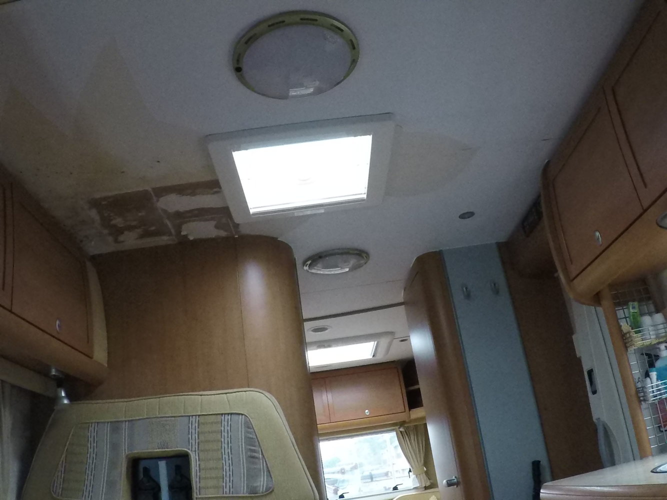

So a week on and having checked all areas of the roof I still have a leak, looked at the sealing of the rooflight and was just about to rip it out and re-seal when I found what looks like an impact of some kind on the roof. Only a small area of damage but I think this time I could have finally found my issue!
My approach to fixing this will be like the last roofing repair, fibreglass underneath (once I have ripped the ceiling down) and gelcoat bodywork filler on the top!
