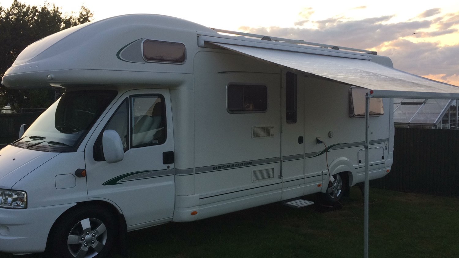

Within this thread I will document what I find as our Bessacarr MH failed on a recent Hab check for dampness. The ceiling has started to go spongy after our first trip away. We purchased the MH around 6 weeks ago and the owner stated that the leak in the roof had been resolved as the ceiling was a little spongy and showing readings of around 10-15% when checked. Well that appears not to be the case as the readings around the skylights are now showing 30-45%. I knew when we purchased it I would need to undertake a ceiling re-paper, what I did know at the time was how badly damaged the vehicle was going to be.
Thankfully there are forums like these on the web and after reading the thread by The_Kraken "My DIY dampness project" and being quoted around £10k for just the labour I thought I would have a go!
Any help, guidance and advice will be gratefully received by the wider community.

Wishing you good luck with the project, the MH looks lovely and, although I know you certainly didn’t expect this it’s good you are having a go.
