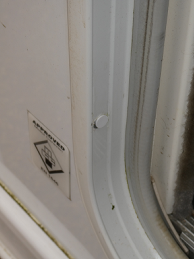

Here's my hab door contact, small like button nearly flush to the door frame near the bottom of the frame and a magnet in the door at the same position.
If you have that, let my know and we can go on from there.
View attachment 490603 View attachment 490604
