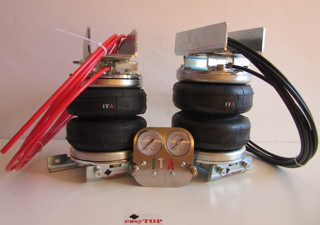

I fitted the Easytop system to our previous motorhome and it was a big improvement.
Thinking about fitting the same to our current van.
Does anyone know the typical lifespan of these units?
5 years?, 10 years?
One concern I always had was that it was another thing to go wrong, most likely when a long way from home.
Read somewhere 10 years .
the worst that can happen if they go flat is your back to your usual suspension as the air bags will still act as the buffer you removed .
