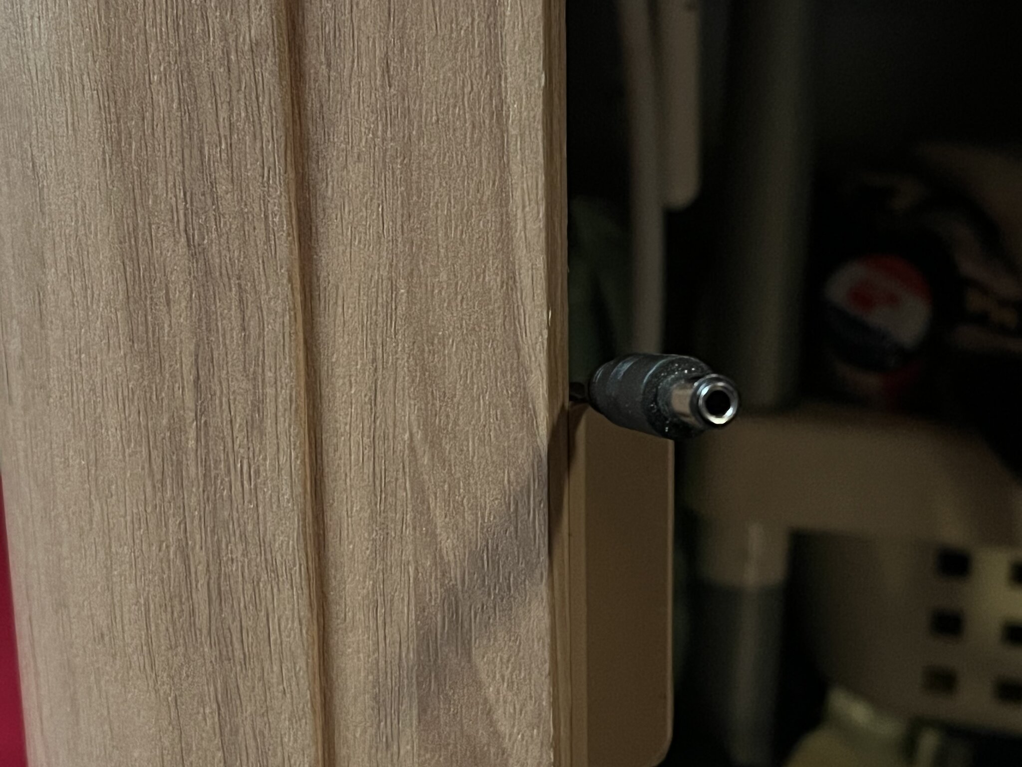

The Vision Plus has a 12v supply that I intend to use to power the Huawei but I’m wondering how to check the polarity of the Vision plus lead using a multi meter.
I’ve attached a photo of the lead and the Vision Plus if it helps? TIA
Normally the centre pin is +ve but to check push the +ve terminal into the centre and hold the -ve against the outside sleeve.
EDIT just remembered the Vision Plus box normally has the polarity marked on the underside of it (next to the socket) and the centre pin is +ve on ours.
Just checked and there are no + or - markings on the socket. But have tested and it is as you say. Thanks all👍

i’m trying to fit a mifi in the van and replace the Vision Plus aerial with a Poynting aerial on the roof. I will use my existing Huawei router which has the necessary aerial sockets.
I’ve attached a photo of the lead and the Vision Plus if it helps? TIAView attachment 596755View attachment 596756
The centre socket is always positive. The outer part which you can easily touch with your fingers is negative.
