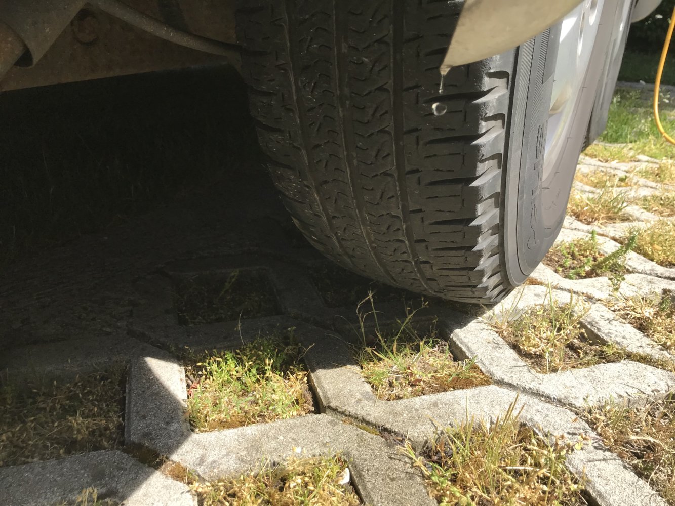

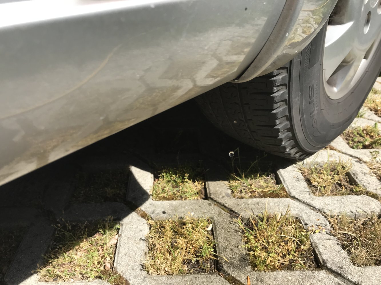

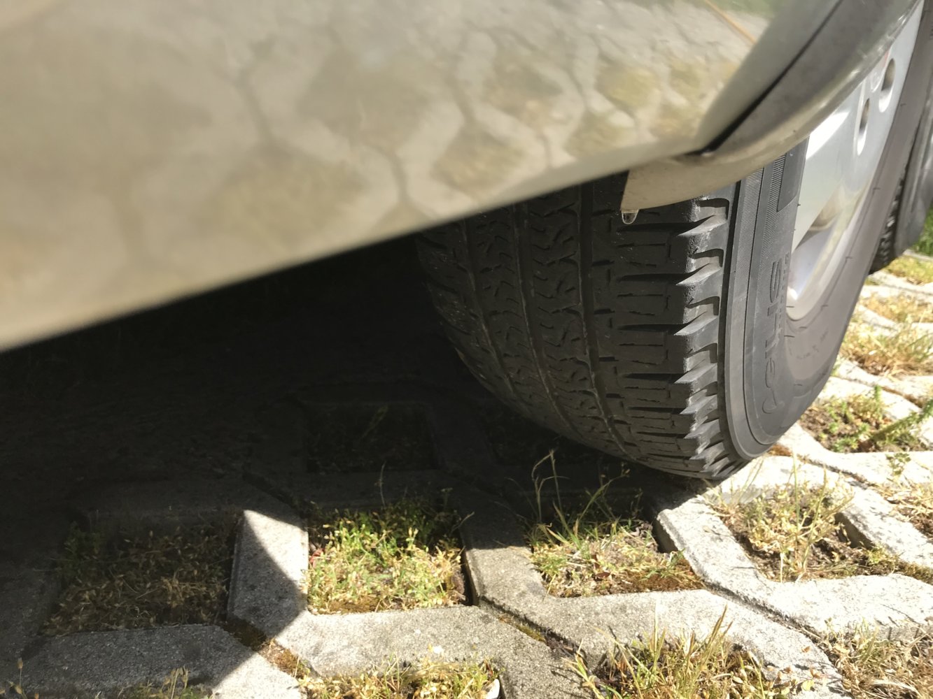

Argh! Discovered a mysterious leak visible just in front of the first rear axle:
Drip
Drip
Drip!
The leak was a little more profuse than shown in the (post fix) photos!
Found the culprit (the second from left connection on the cold water manifold):
I struggled a little to make a good connection until I realised that these connections sealed in the opposite manner to that of an olive connection. The seal is made by screwing the knurled knob away from the manifold down onto the hose!
Access was a little tight:
..... and I couldn’t be bothered to take the door off!
Interesting to see how far the water was travelling before it made its exit. The leak was originating more or less in line with the water filler cap and was exiting in front of the foremost of the two rear axles.

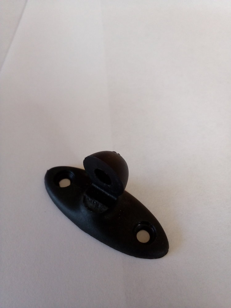

Our Hobby has two lockers on the N/S that have gas struts.
Don't know how but one of the hinges to thesnapped. I looked for alternatives but couldn't find anything suitable so I made one.
Not exactly of retail quality but, for a first attempt I'm happy.

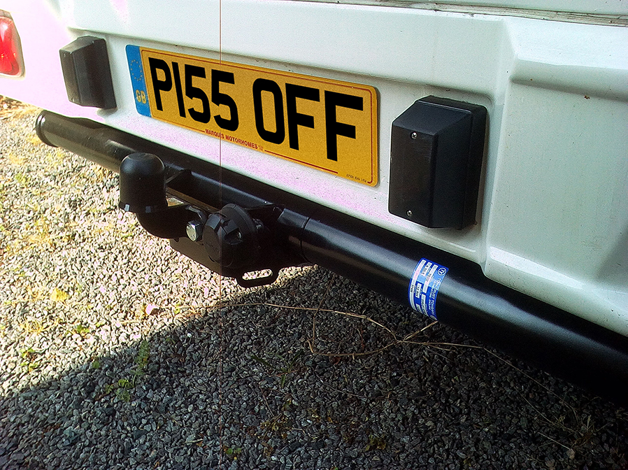

Converted a Fiat Ducato PV a while back
This week I fitted a type approved towbar to go with the electrics I fitted the other week.
After getting quotes and realising how easy it was to do I bought a kit from Just Tow (justtow.com) who delivered it fast incuding the CANBUS electric box and wiring loom.
This has saved me around 800 quid and was really easy to do.
Oh I'm lovin that registration number.
