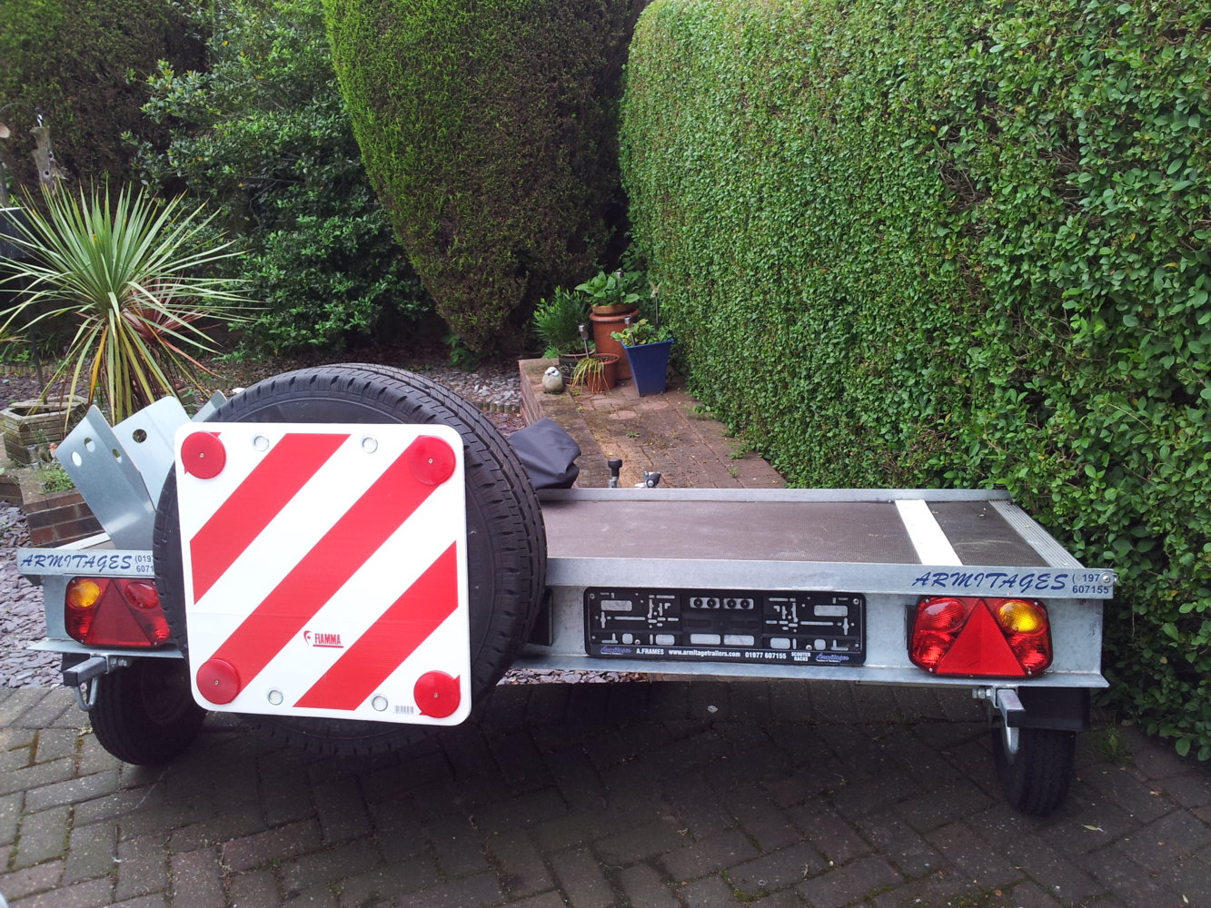

Not on the m/home but on the trailer. Wanted to reduce the weight in the garage by moving the spare wheel so made a mounting bracket which attaches to the rear cross member on the Armitage trailer. I then fixed a strip of uPVC to the bed so that I can pull the back wheel of the scooter further forward to counteract the increased weight on the rear of the trailer which would have made the nose weight too light. Also made a simple fixing for the winch so th
at it was removed from the rear locker as well.
