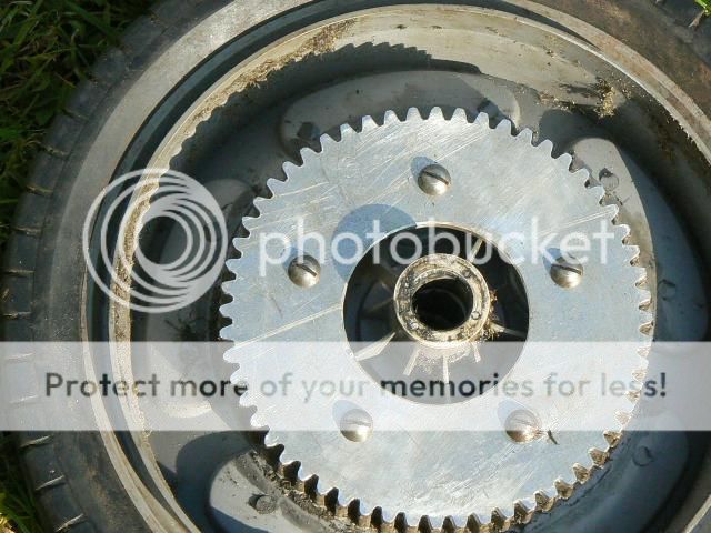

A while ago I bought a grass sweeper/collector secondhand, being sold as it was breaking the drive gears and replacement wheels cost £77 plus postage each. I stripped it and replaced a number of bearings then turned my attention to the gears, they are plastic and cast as part of the wheel so I resolved to improve the design and make a replacement gear out of aluminium. After preparing the blank I mounted it in a dividing head on the vertical mill. (yup those who have seem my man cave often wonder if I actually use any of it).
With a little nifty maths the correct involute cutter was determined to be 10DP and 56 teeth needed cutting
Eventually a gear was produced and fitted. Tried in place and it runs perfectly. Magic. I may as well make one for the other end as well to halve the wear, should last me a few years.
Finally fitted in place

look's like a nice job roger
