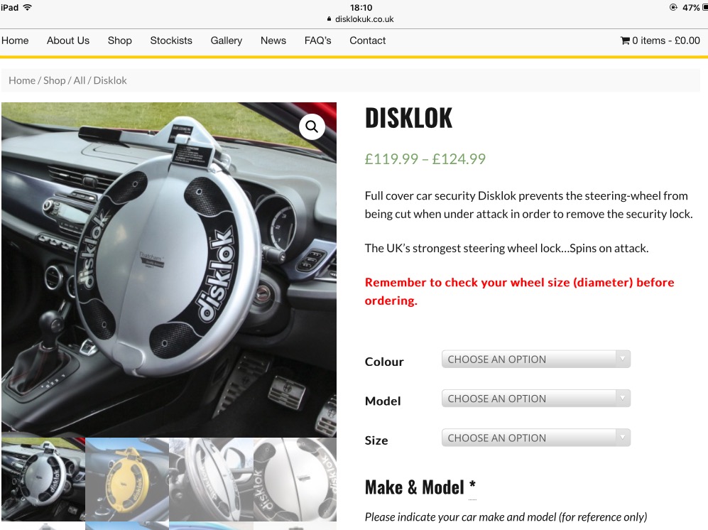

Well did everything you all suggested it lasted from 8 pm to 11 am then it went off .think it's knackered .sso untill we can get a new alarm can anyone suggest something to put over the stearing wheel or pedls even when we get anew alarm it will be extra securety.thanks
A documentary on tv some time ago ... the ex car thief turned good said these were the best deterrant and that he would ignore any vdhicle with one .. in his thieving days.

Will get a wheel lock in morning theres a screwfix 10 mins from us thanks .
we have a disklok, highly recommended, we have also a cobra alarm, pro plates on all the door handles, heo safe locks on cab doors.........
and dogbert, our russian black terrier @ 50 plus kilos, and im a keen target shooter:whistle:
Well we bought this one and it was to small so had to buy Disclok large size.
