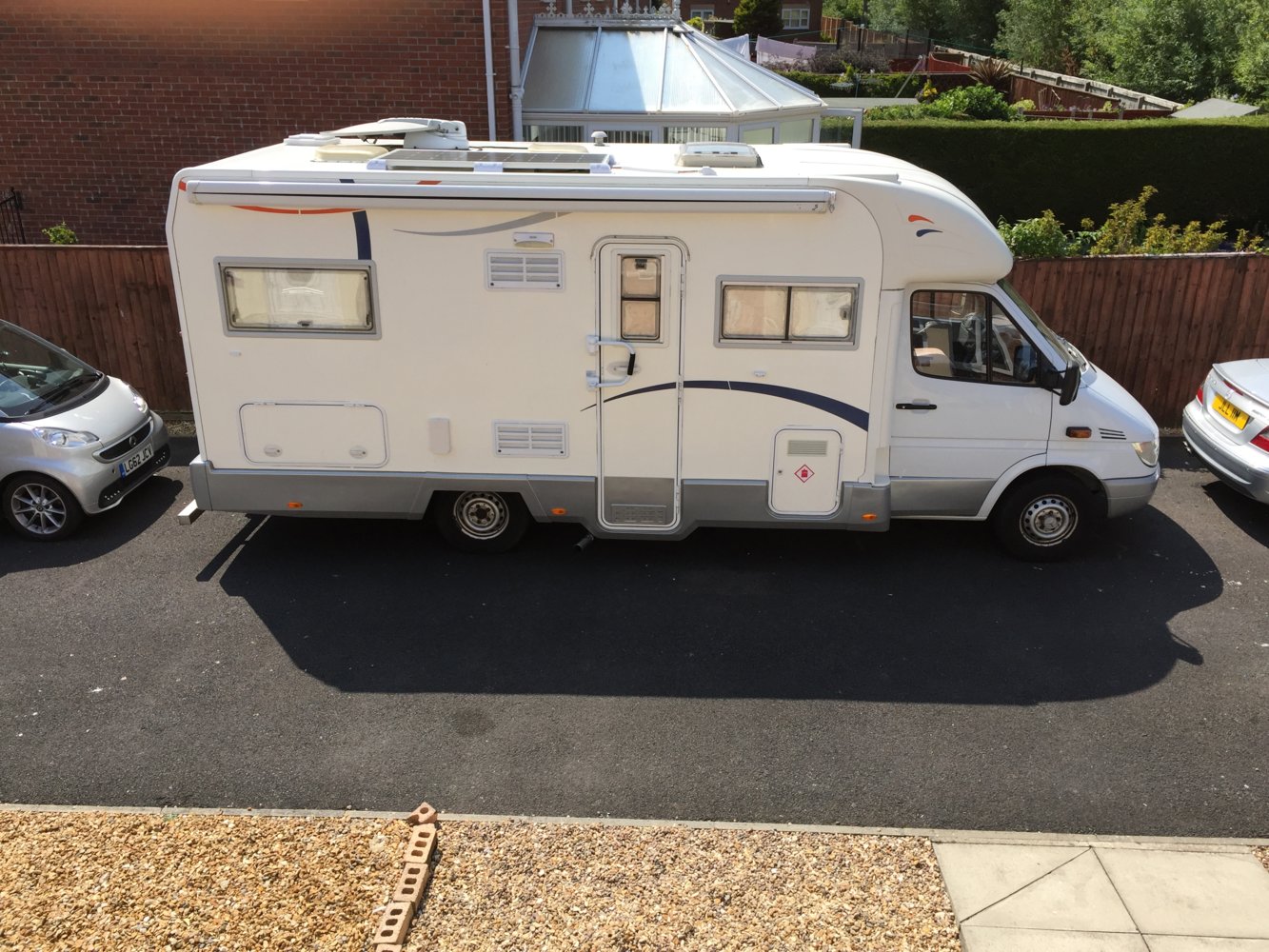

No it’s pretty busy up there see pic

It’s tight up against the rear roof vent looks like it will have to be a couple of those turbo roof fans

Would the panel not go crossways at the front?it looks like the cable would be long enough and you wouldn’t need to make any new holes.

No room at the front big roof vent there

Just been looking at your van on the picture you attached.. Turn the solar panel sideways so it is installed between the back of larger front roof light and the one I am assuming you were intending to install the aircon to behind.
A Dometic freshjet 2200 will literally not overhang any further foward than the existing 40x40 roof light you have installed currently. All the overhang of the aircon unit is overhanging the rear so it would fit. the only thing you may need to do is move your satellite system back a little, or by the picture it does look like an Oyster system so you adjust the lowest pivot able swing on the control panel in the hidden menu (speak to Oyster) so it would not hit the aircon and simply swing over the top of it whilst searching..
