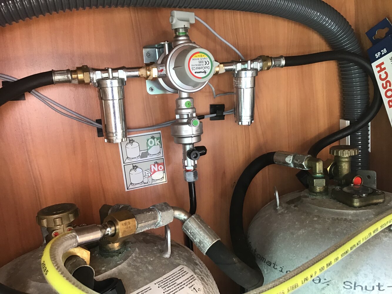

If i did that on ours the pipe would exit lower, also meant messing about with the copper. Was like that when we got it, I've just added stainless piggy and gasit bottle
If talking about yours is that an impact shutoff valve at the bottom? Can't mount that horizontal if it is.

Whats the main difference between the one in the photo and a £45 one, minus the gold obviously?
It is a dual regulator with auto changeover, can be connected to a Duo Remote C which gives remote indication when the bottles change over. Also has the crash sensor & heater for cold weather.

I had two Truma crash sensor regulators fail. Truma replaced them both under warranty but recommended a filter being fitted due to contaminants in bottled gas causing the crash sensor ball to stick. They also advised that a lot of Moho manufacturers incorrectly site the regulator too low, causing the contaminants to enter the regulator from the gas bottle. (The hose from the bottle should rise up to the Truma regulator)
I did ask that if they know its a problem with bottled gas contaminants, why they didn’t provide all regulators with a filter... the response was... “we leave it to the customer to decide if that want a filter”.....

By way of update, just returned from Autogass 2000 where raised our regulator so that it's higher than the 80% level of the Alugas bottle and fitted the Truma filter. All done in 30 minutes including a though test for leaks. Chris and his team of Jon and Wendy are very thorough, knowledgeable and friendly and we were entertained by Jon whilst he worked.
Feel much happier going away in January now that the regulator has been raised and there's a filter in line. I did a fuller review of Autogass 2000 in the 'Review' section but heartily endorse their services.

I've been back to the van to clean it and otherwise prepare for our trip in January. So I've attached a photo of the filter now fitted and the regulator raised. I haven't yet cleaned out the gas cupboard! I've also posted a photo of the regulator before fitting the filter.

This is my set up, filters are replaceable.
Not much room for anything else !
