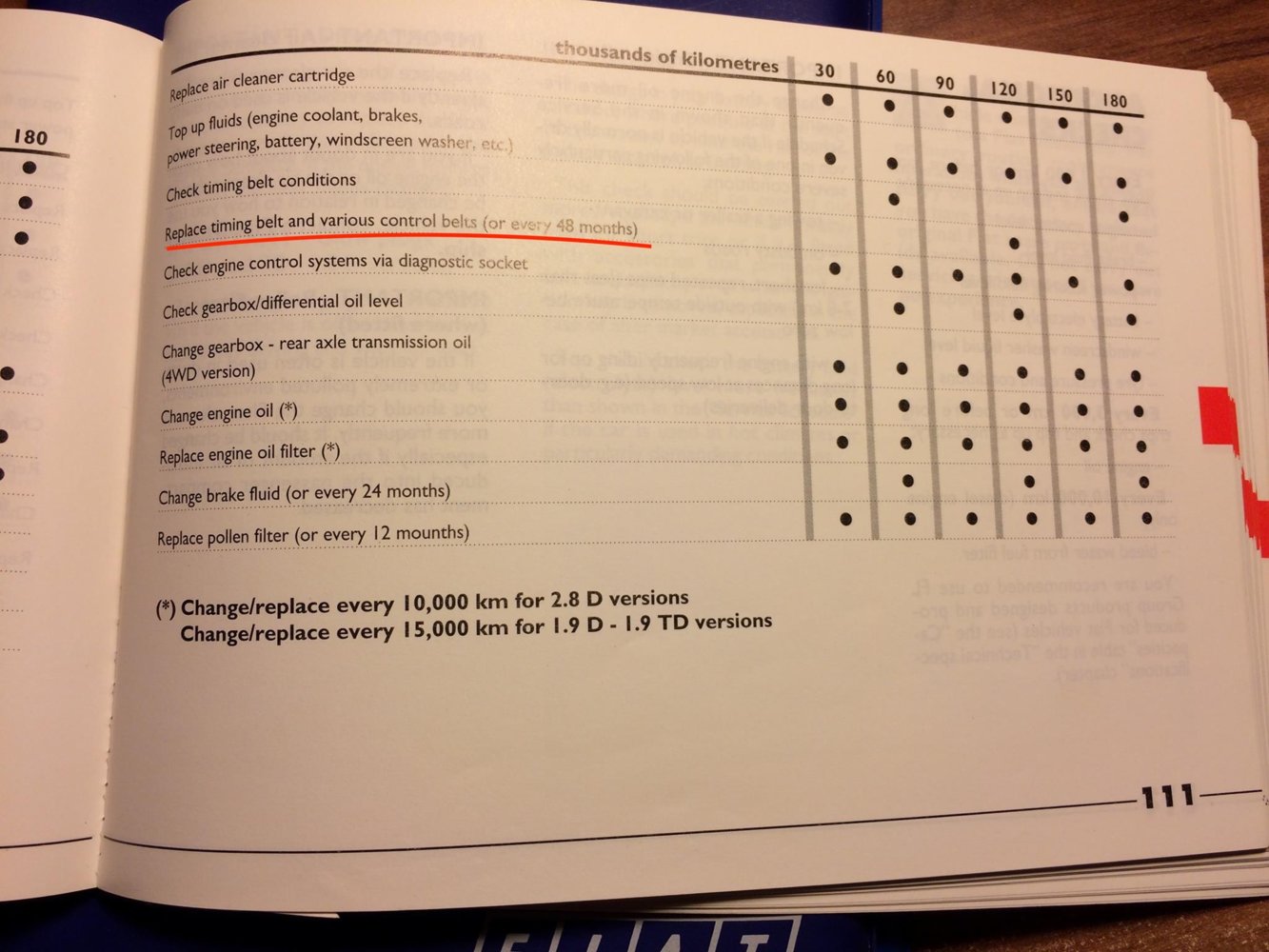

If it's a Ducato 2.8 JTD it should be changed at 120,000 km (74,564. ml.) or every 48 months
always check the owners handbook.. 23119894_1973185626229132_3371317870086443485_o.jpg
If the vehicle is sold here in Spain,or anywhere classed as hot, then the mileage /kms are half what they are for changing as the UK
