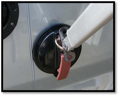

Very much like the look of the German suction brackets that Wombles listed but like the price of Minxy Girl's better.
But, do I recall posts a while back cautioning against using these types of suction bracket on the aluminium/foam side walls of vans?
Something about the thin aluminium separating from the foam inside?
Or am I imagining problems where they don’t exist?

Thanks for the info about the multiAnker it looks really good - I am one of those sad people who has had the misfortune to have had a Thule Omnistor wrapped round my Motorhome roof In high winds! It happened in the early hours of the morning, an unexpected strong, gusty, wind developed without warning and the awning was complety & utterly wrecked. Indeed, the tensioning bar broke into separate pieces, and all we could do was cut the fabric off with a Stanley knife and put all of the broken bits in a skip and then get a complete new one fitted! Which spoilt the end of my holiday; it is a experience which understandbly I have no desire to repeat. So I have ordered a set of these suckers tonight - I note that they say they can each support 70kg - which is certainly very much stronger than tent pegs - thank you!

Just make sure that where you stick the suckers on the MH is a strong point otherwise you might lose the panel!
