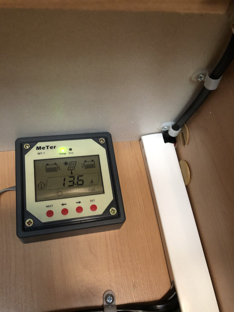

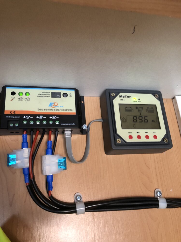

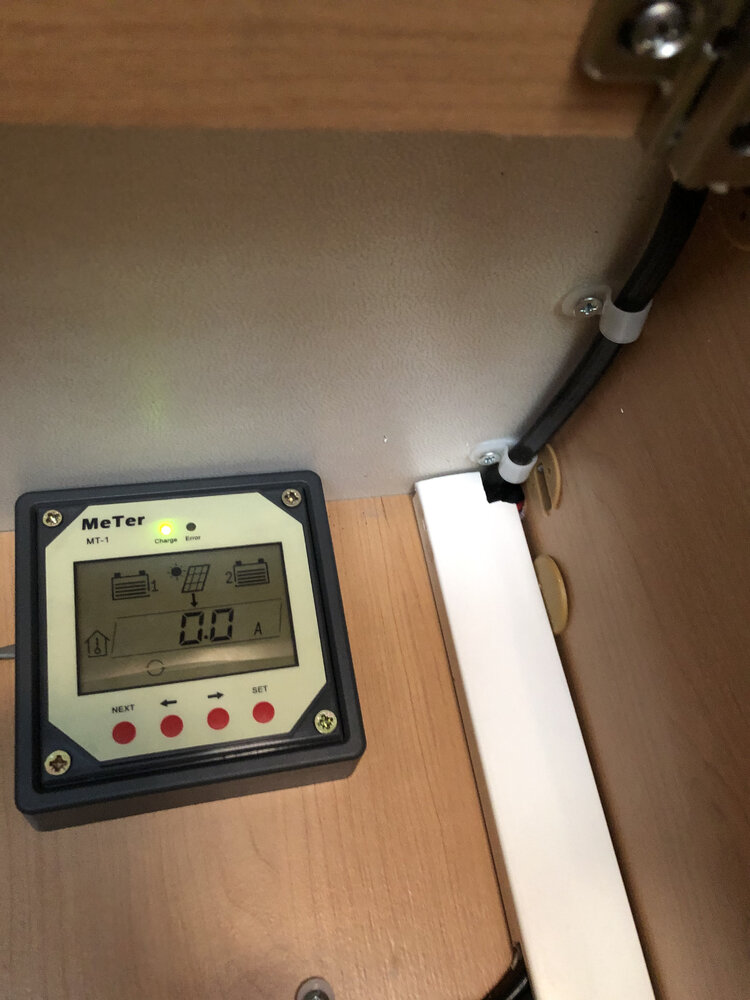

Our van is in storage ( outdoors) we have solar panels and currently sat outside it with engine on to turn it over intend to take it out later this week for a run out. No idea what these figures mean on the panel anyone tell me if this is good or bad ?
I'm not familiar with this solar controller, but at a guess, 70:30 is the percentage split between the leisure battery and the starter battery. There will probably be a menu somewhere to change this if required. 90:10 is quite a popular setting.
20.3V is the solar panel voltage. I think 13.6A is the solar panel current (amps). That's the input into the solar controller. If it is the solar panel current then the panels are generating 20.3 x 13.6 = 272W, so you must have a lot of panel up there.
The output voltage to the batteries will be about 13V to 14.5V, and certainly not 20.3V. You'll have to press the appropriate buttons to show that.
The 896Ah looks like the total charge from the solar panels since the measurement started. There's at least a week's worth there, or much longer if during the winter months.
I don't know what the 0.0A means. If it's the amps going to one of the batteries, maybe there is a problem there. Bad connection or fuse. The amps are unlikely to be zero, unless one battery is completely full. Or maybe it's one of those controllers that doesn't charge Battery 2 until Battery 1 is at least 70%.
