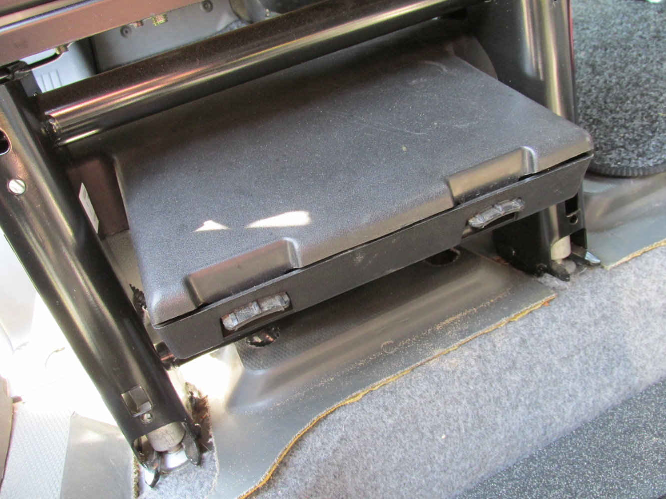

It's the same as the drivers seat, with all the adjustments etc., but the levers are on the left side and the arm rest is on the right. It even has the fittings to take the plastic case that holds the jack/wheel brace/tow eye.
If you undo the 2 bolts at the front of the seat, disconnect the wiring connector underneath, the seat slides forward & then out. Easier with 2 people, it's awkward rather than heavy.
The pictures show mine with a swivel base which is an addition, works well with or without it.

Am I correct in thinking it literally has two nuts to undo then the seat slides forward and lifts out. Wow! That’s simple if I understand correctly. Thanks a lot
So nuts to undo then it slides forward and out
View attachment 233271 View attachment 233272 View attachment 233273 View attachment 233274 View attachment 233275

Yep 2 bolts at the front - I used a 16mm socket, but an offset ring spanner may work
Plus the wiring - a connector for the seat belt warning
As I posted earlier, lifting out the old one (double) can be done by yourself, but I recommend a helper as it's a bit awkward

My swivel is a CTA swivel - they do make the seat a couple of inches higher.
There is no rocking.
When mine is in the standard position facing forward, it will swivel without adjusting it. If, when swivelled, I recline in it, a bit of adjustment may be necessary to spin it back round as it touches the door.
I have a disabled friend who finds it easier to go into the van via the sliding door and sit in the seat, I then rotate her & the seat to face forward. Works for my old Mum as well. The seat 'locks' into position when facing forward, momentarily pressing a red lever (between the occupants legs) allows the seat to swivel.
If you are going for the swivels, fit them before you install the seat - not necessary, just easier.
Make sure you double check your seats have the same fitting as mine and the one you buy is the correct one before purchase!
